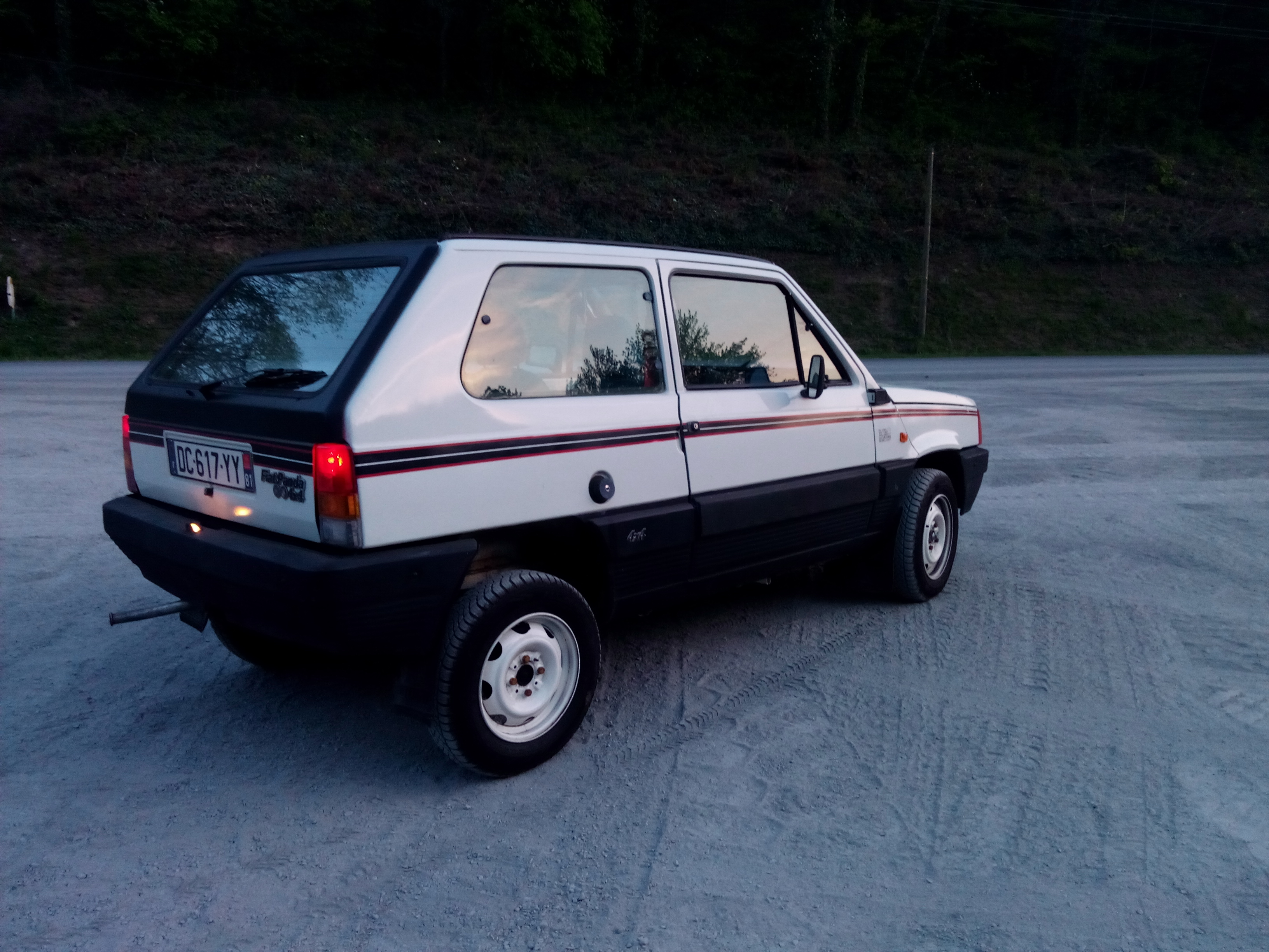

I have a nice mkI 4x4 with the old pushrod 965cc engine.
https://www.fiatforum.com/attachment.php?attachmentid=189288&stc=1&d=1521898375
While it was ok....ish, I never had much confidence in it. Engine swaps are limited for the early cars like mine as a FIRE series will not fit....different bell housing, different engine mounts, different exhaust routing.....anything is possible, but its not really a simple swap.
The only "bolt in" solution is to keep the same basic block, which leaves the 899cc unit as fitted to the Cinquecento and some Seicentos.
While reducing capacity may seem silly to some, the advantages are many - getting rid of the crappy carburettor and useless autochoke and getting SPI fuel injection instead....getting rid of the wobbly distributer and less than reliable points and condensor and getting DIS electronic ignition, and in my case getting rid of a nasty dry bearing noise from the camshaft area of the old engine.
So is it easy? well, yeah, it is actually - its not a total breeze but its not incredibly complex either, its basic spannerwork and minimal wiring.
Im not saying this is THE way to do it, there are loads of variations to cars throughout the production run so you might encounter differences, plus I am in France, so LHD, which will be slightly different to UK.

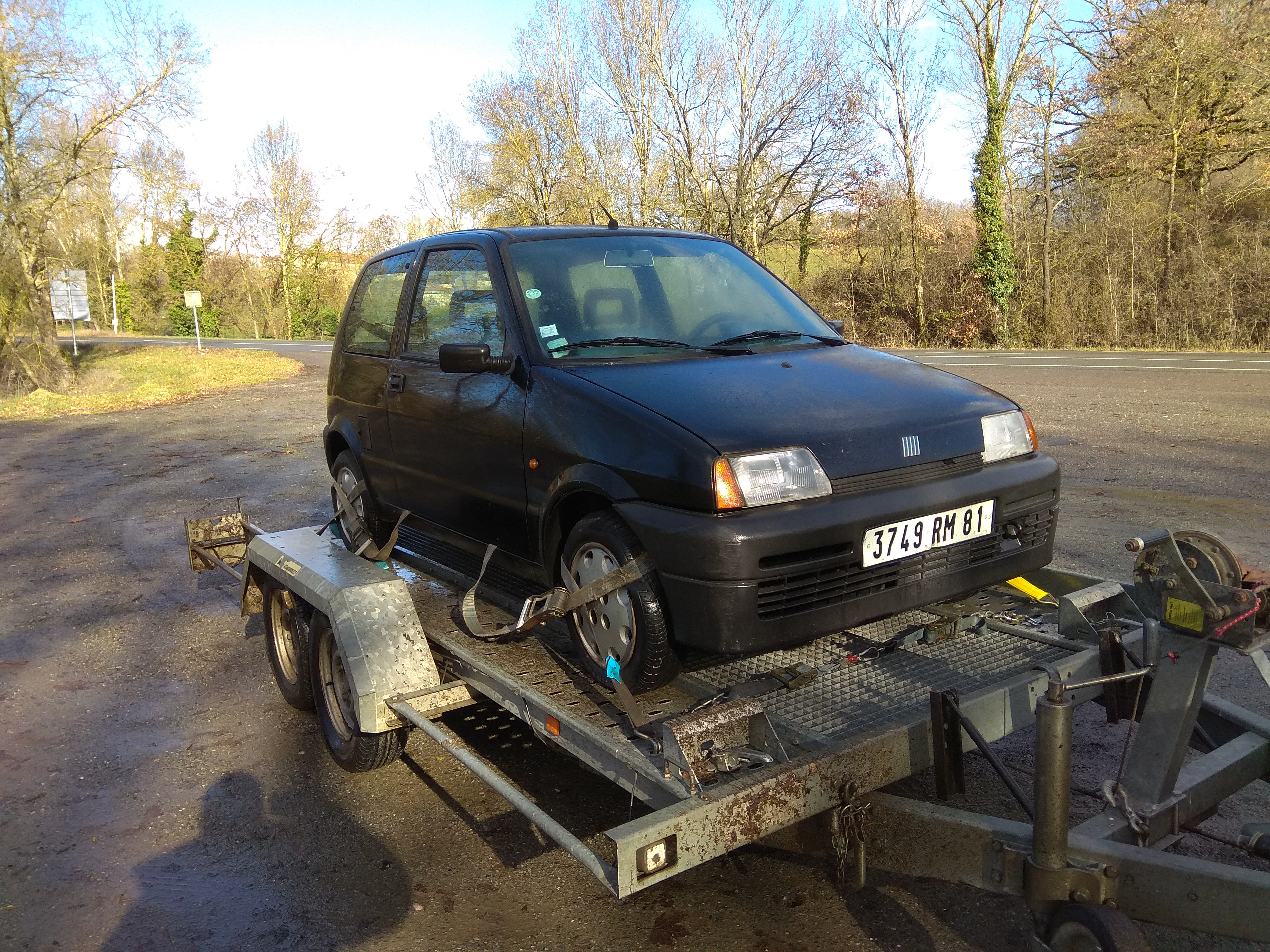

I bought a whole Cinq cheaply because it had blown its head gasket.
https://www.fiatforum.com/attachment.php?attachmentid=189289&stc=1&d=1521898856

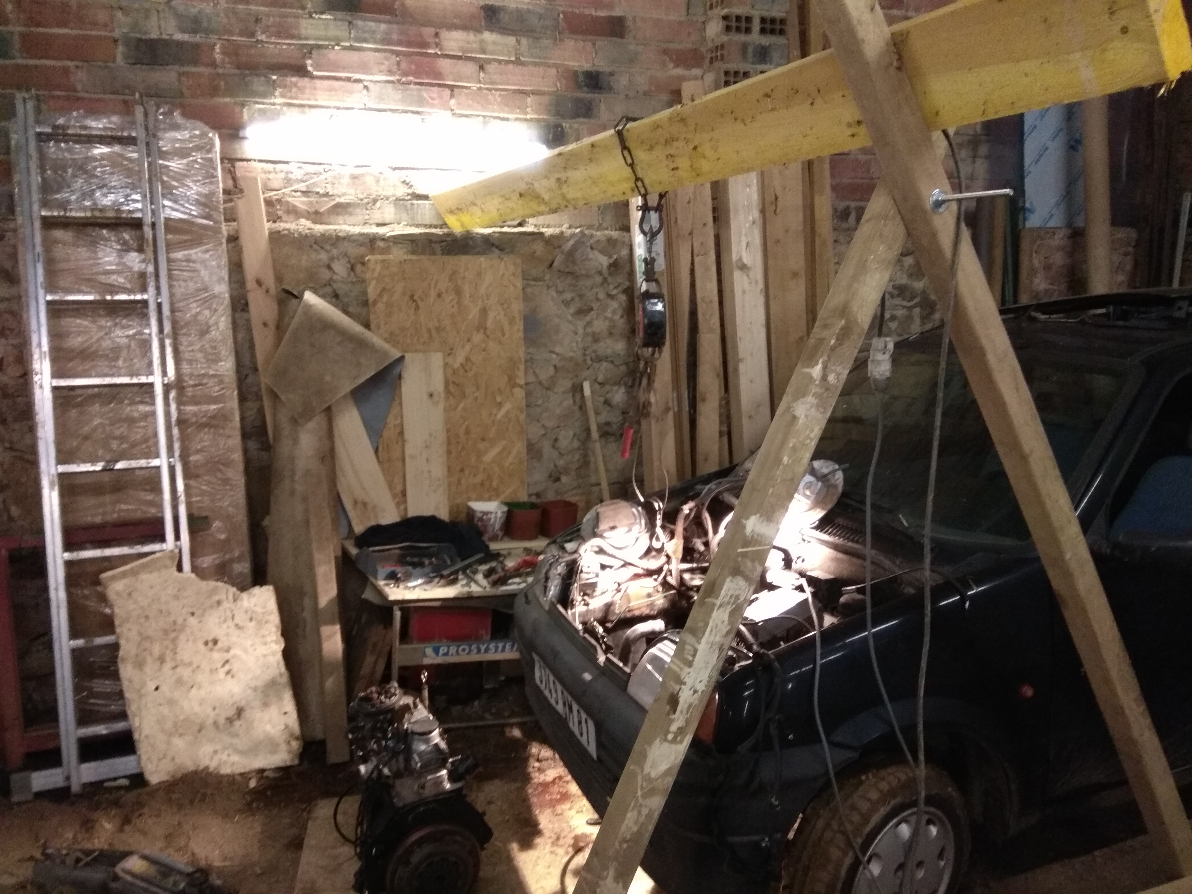

I fixed the gasket first and ran the car for a while to test the engine, then pulled the engine out.
https://www.fiatforum.com/attachment.php?attachmentid=189290&stc=1&d=1521898969
I then dropped out the whole Panda engine and gearbox by lowering it out the bottom of the car and seperated it from the gearbox on the floor.
The cinq engine bolts straight on to the 4x4 gearbox, using the original 4x4 clutch (mine was only a few hundred miles old so I never changed it, you should probably change yours if its old) and then lifts up into the Panda engine bay as normal and bolts right in using the standard engine mounts.
My engine mounts were a little tired so I filled the voids in the rubber up with sikaflex to strengthen them a bit and reduce engine rocking.
With the basic engine in place, you can start with the ancillaries.
