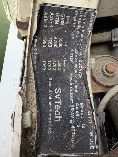

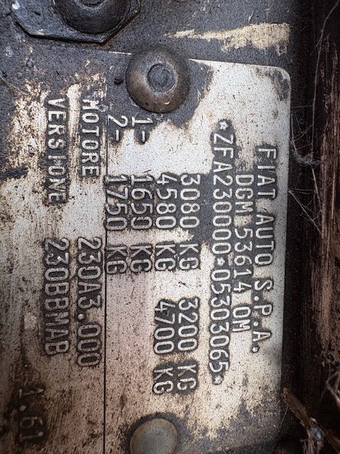

Sorry here are the No's Chassis Number ZFA230000005303065 Engine No 1911729 MOTOR CARAVAN First registration UK March 1997 FIAT DUCATO LEFT HAND DRIVE USER MANNUAL IS in Italian suggesting made in Italy.

You have to look at the plate in the engine bay for the engine type/series id number.
Or post the engine cc the type can Then be worked out.

Engine Series Number 230A3.000 so Turbo 1929cc engine with a Bosch injector pump number VE-R547
