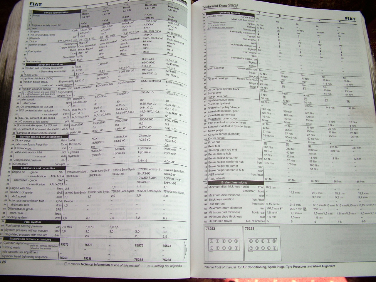

1997 Barchetta: I have removed the cylinder head and am replacing the gaskets after a light skim of the head facing. Is the replacement of the head bolts compulsory, or can they be used a second time?

This is all I can find.
It appears to indicate not needed to renew, but check they are your vehicle details.
