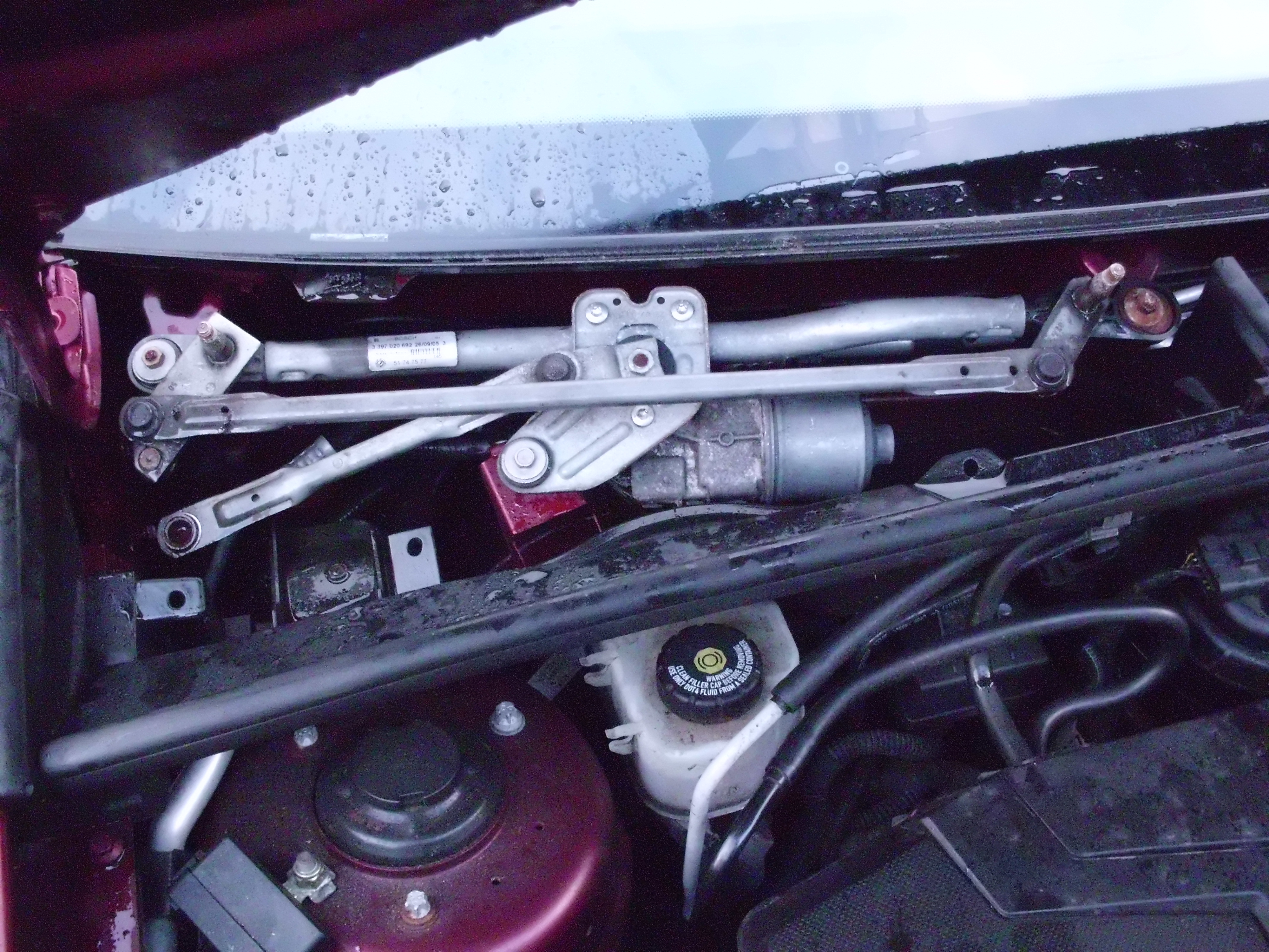

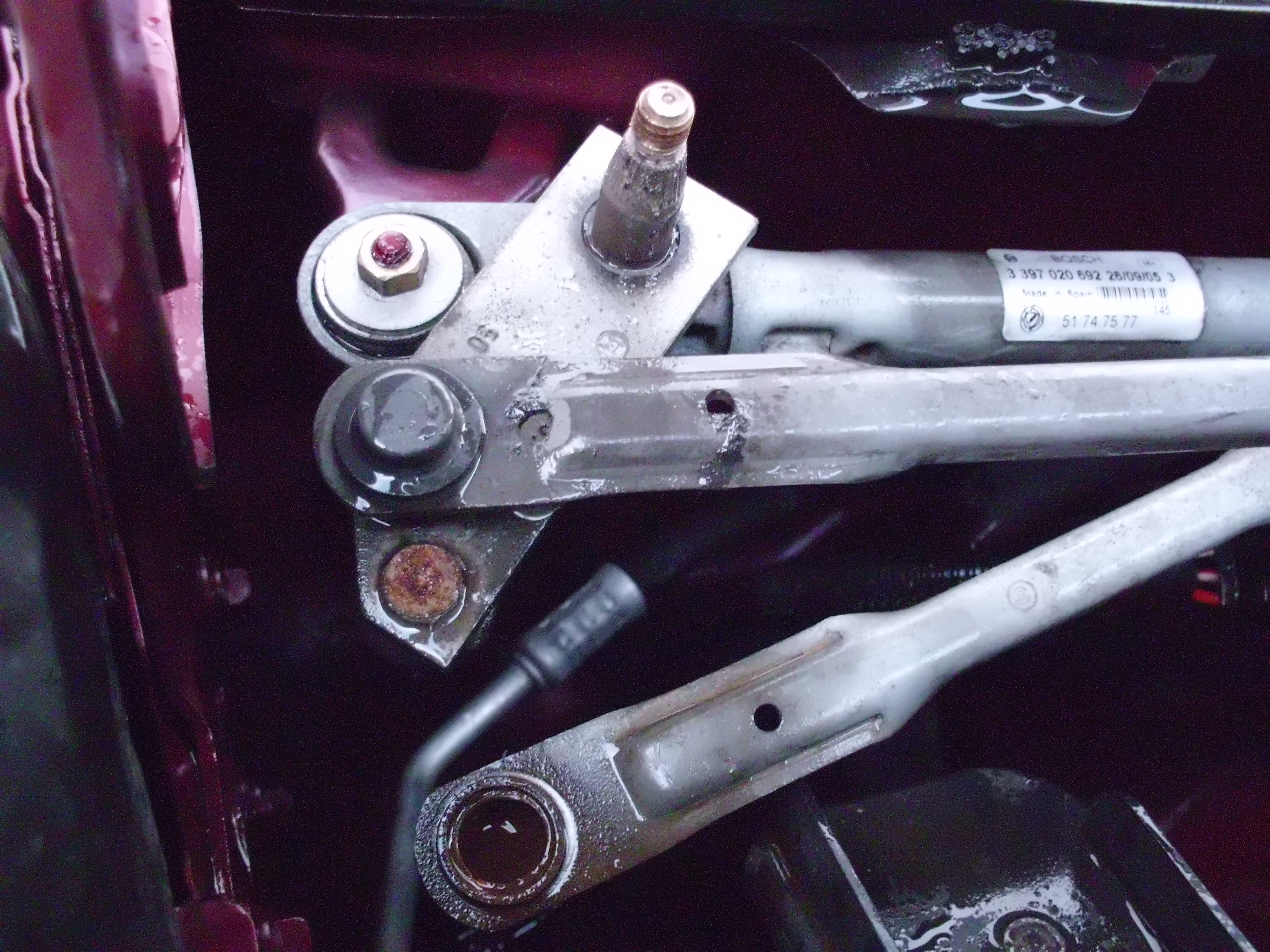

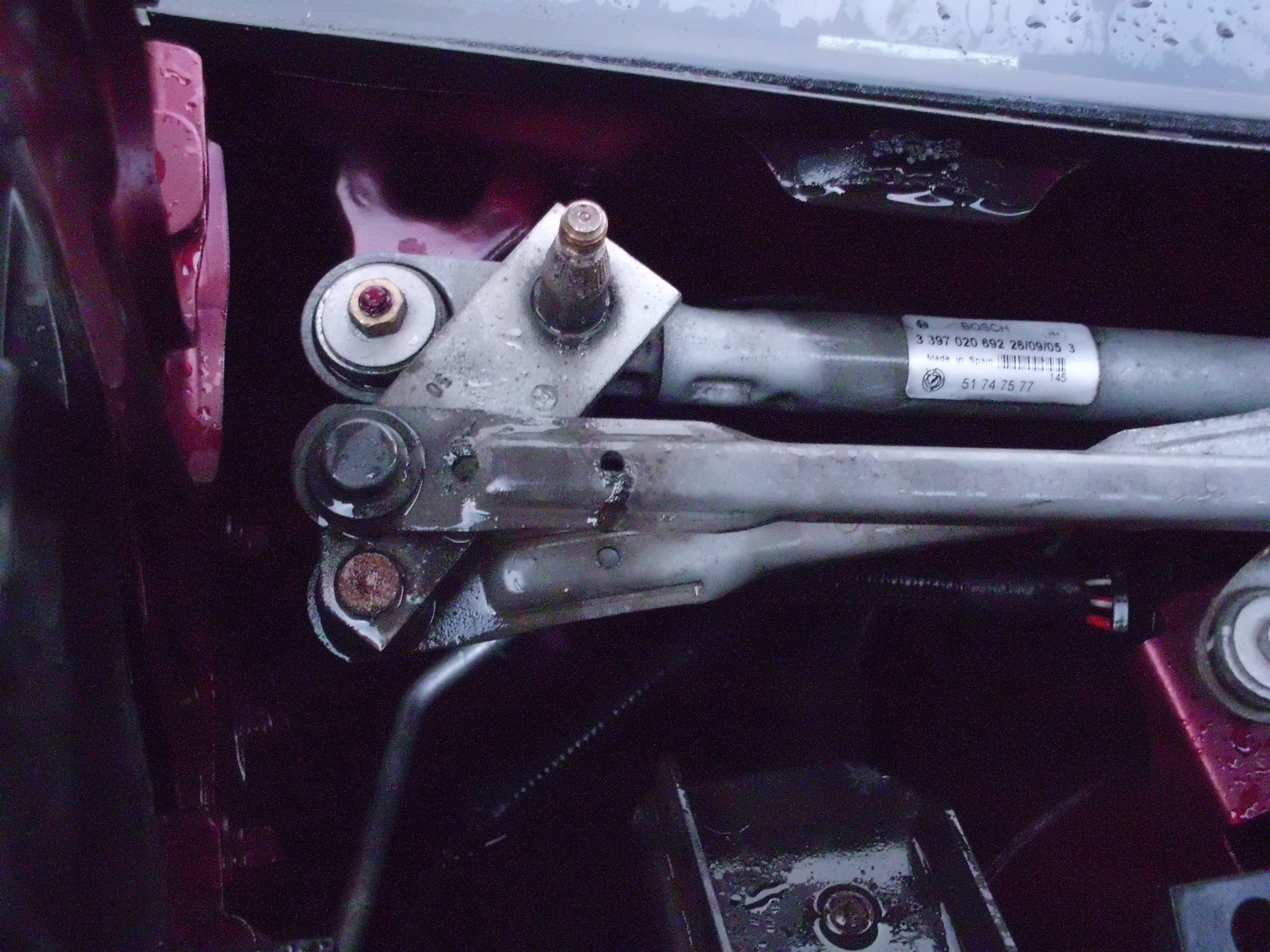

You were spot on. My wipers have stopped today, stuck in the up position. Motor still whirring.
I'm going to have a look and see what the problem is. Will then get in touch with Wipex and see if they're interested in making a kit for it.

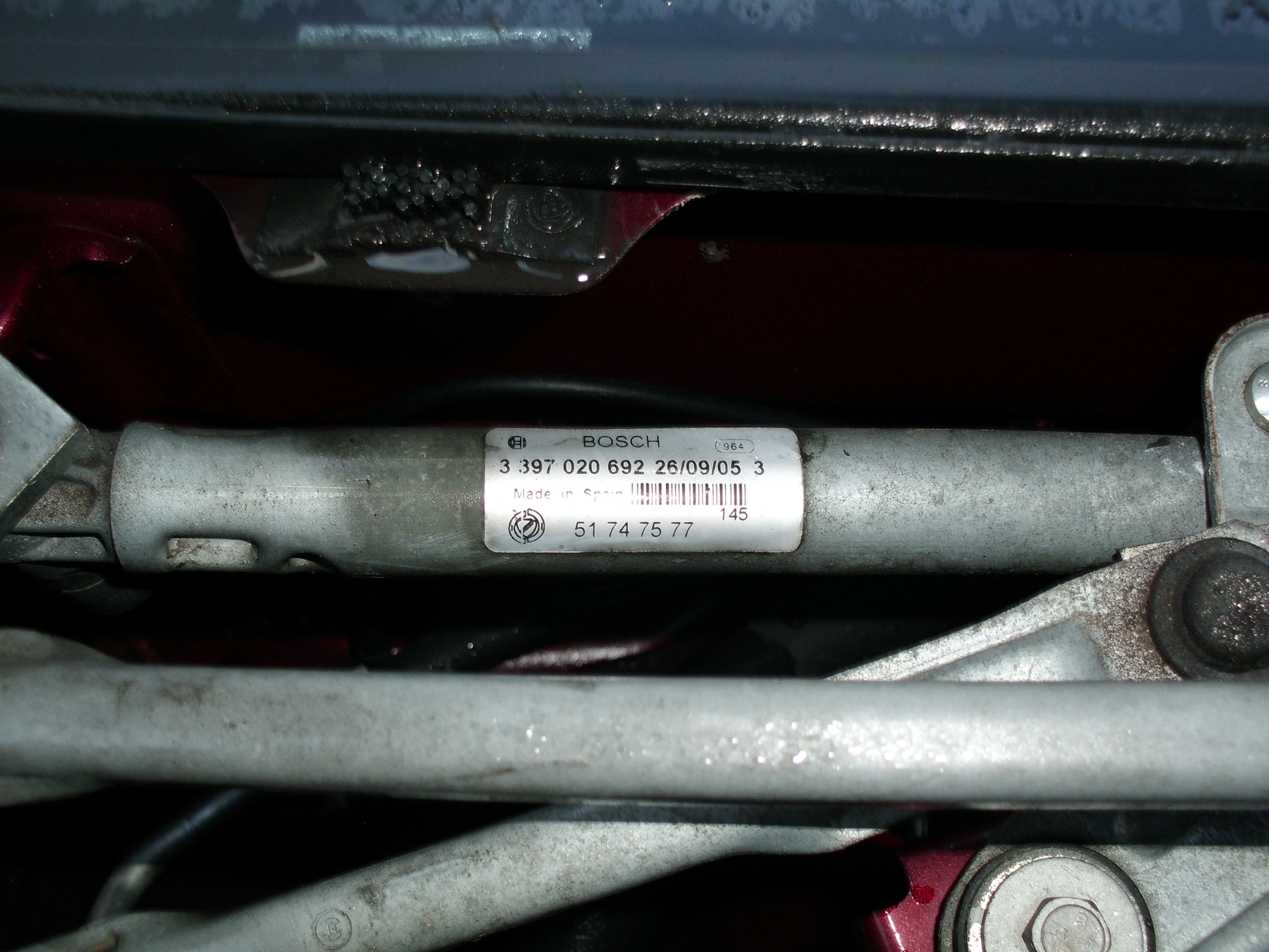

Photos of linkage included, showing broken joint and Bosch part no. Googling for the part no doesn't show anything. Will ring Wipex, see if they can help...

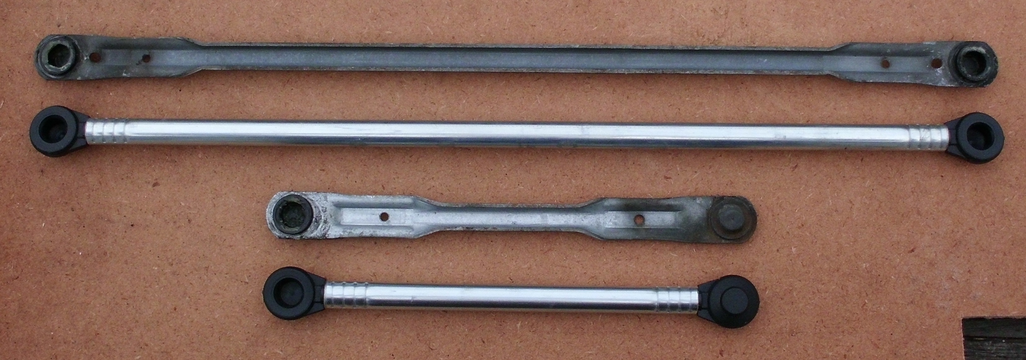

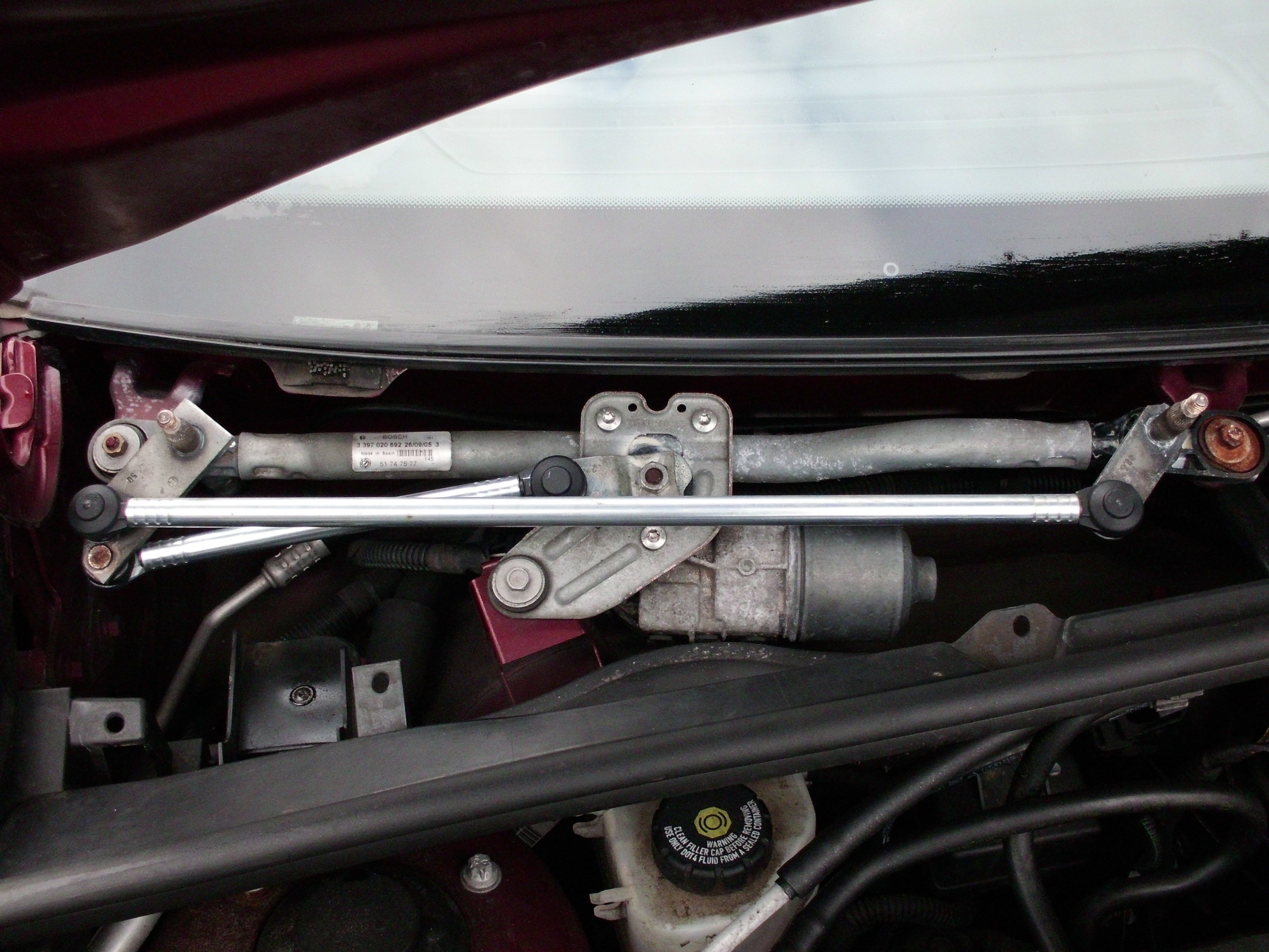

All fitted, working and super!
I cleaned the balls with cotton buds soaked in white spirit, squirted balls and sockets with white grease and assembled. They just clip on - you just need to give them a squeeze on with grips.
The wipers now work better than ever before. They no longer judder like they have done ever since I got the car.
Pictures attached. These should now be available from www.wipex.co.uk.
