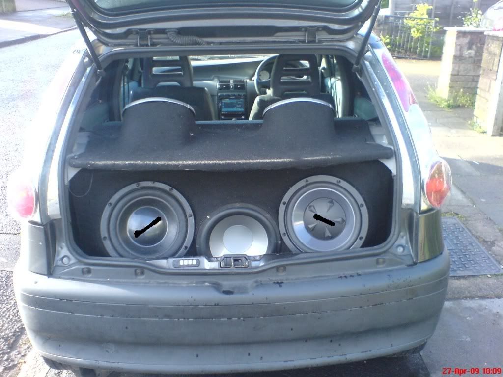

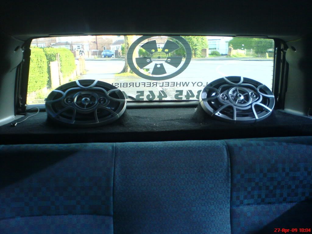

ok well if your putting 6x9's in the parcel shelf you will need to raise your speakers (put on to some pods) make the pods out of wood and fiberglass so that the speakers are facing the front of the car this way the sound from the 6x9's are not just hitting the rear screen and going no where and your sub drowning out the treble
like this

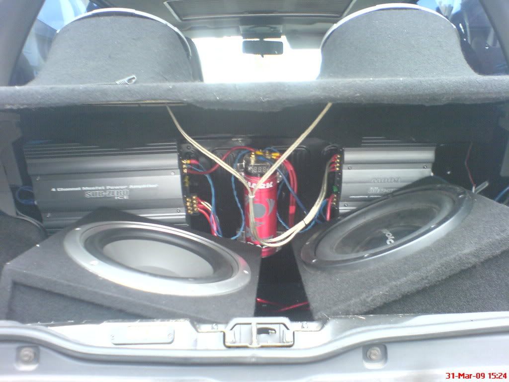

this was my first set up now i have a full boot install :p
ill try post other pics on here later to show you what they look like from the front

As for the picture given, I was going to angle the wood underneath so that they faced inwards, but still wanted them to be discreet so you can't see them. Was going to fully cover them with a thin material hopefully, and the bit of tubing I was after was to just let a bit more through.

plus if you have a ported sub in the boot you have to be careful that the air from the sub dose not damage your 6x9's by being pushed up to far from the air coming out of the sub

What are them black lines on the Subs all about?
And where are you CC bumpers?! :p:p
lol black lines are photo editing ( blank out the names )
and cc bumpers i have but not yet fitted as im trying to find time cos i cant be bothered when i finish work i just want to chill out lol
plus im trying to get my engine sorted before i finish it as i have a knocking coming off the cam but yhh thats on a different part of this forums
