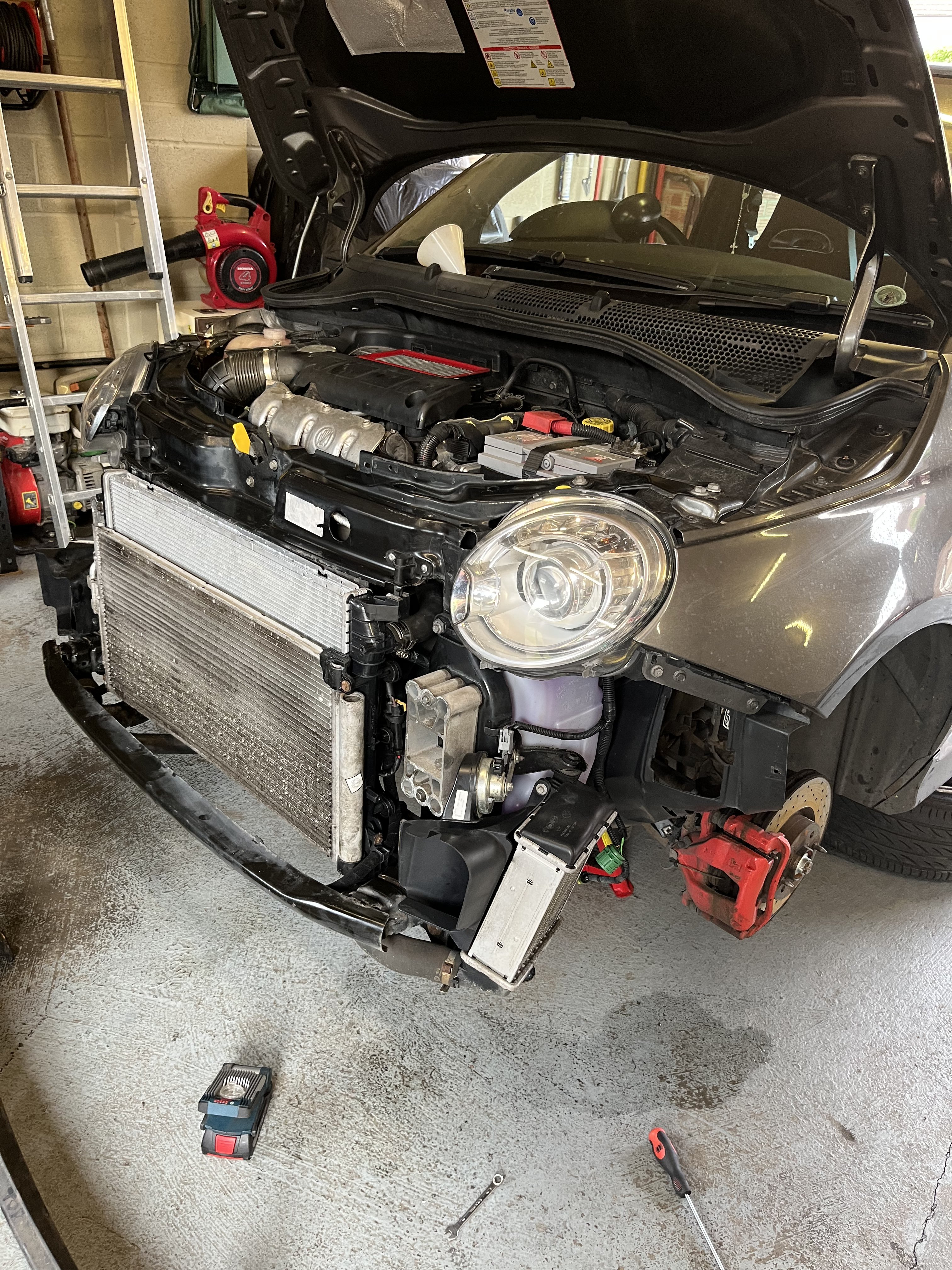

Hi all radiator replaced and problem solved.
Took about 2hours of labour which I gladly did .
Bumper off wheels off and had a chance to inspect and clean all the areas that were caked in coolant .
Changed the oil and filter too made life easier with the bumper off

Hi Varuna, looking at your photo can you tell me which is the condenser for the air con as opposed to the main radiator? The reason I ask my 2015 Anniverario (24,000 miles) is going into a Fiat agent (under extended warranty) this month due to the fact there is a leak on the air con gas its been topped up 3 times & keeps leaking. Fiat say’s the warranty will cover a “fault” but if the condenser is damaged from stone chips or road damage it is not under warranty. I would like to inspect the condenser prior to the car going in on the 17th this month, everyone knows how garages try & get out of repairs on warranty faults.

To be honest I did not look at the condenser but I do suspect it was Denso the same as the radiator,
Not 💯 sure though.

Air Con radiator is always the front one, that's why it gets regularly stone damaged!
