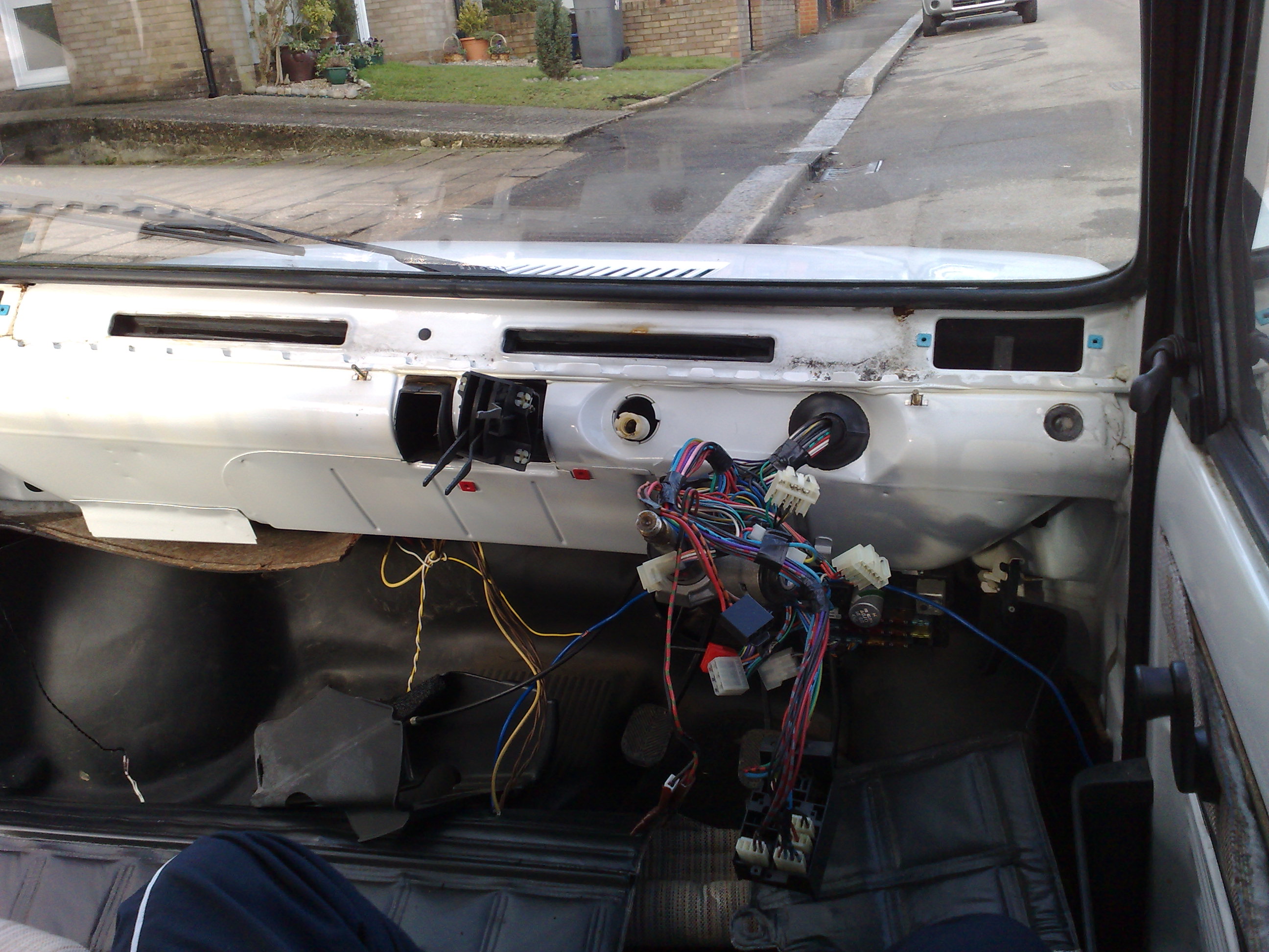

As Petel said, they were handed, heres my dash... nude... :p
