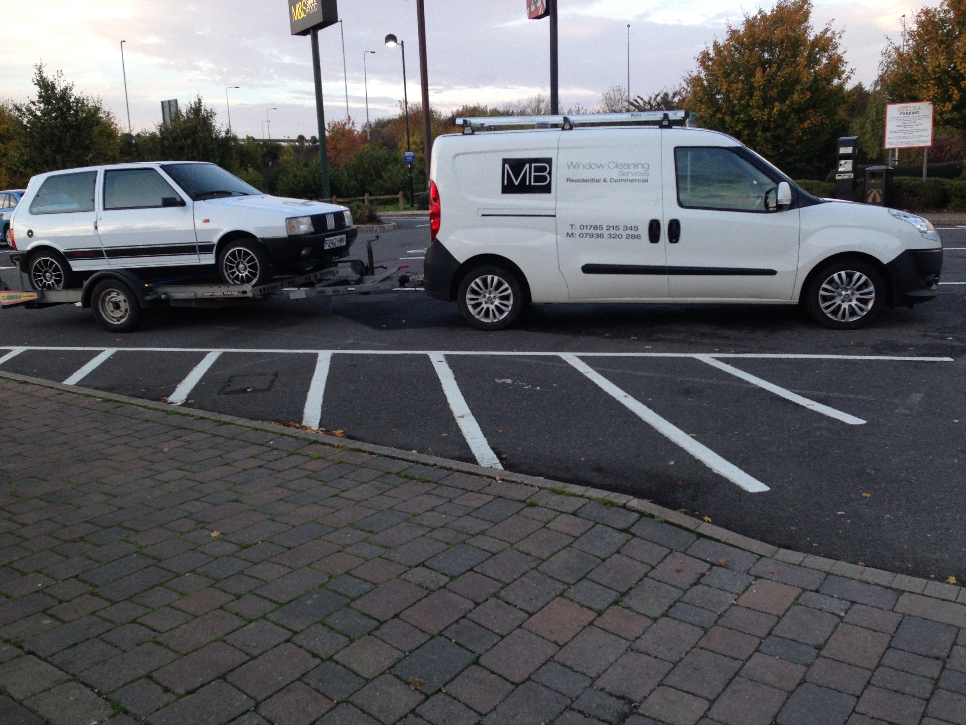

I use my doblo for towing every now and again, it also has 1300kg towing capacity,
I believe it should be higher, the newer doblos have much larger brakes and the engines produce much more torque than the older 1.9's, mine is the 1.6 multijet, if you have the 2.0 it has a 1500kg towing capacity,
you must make sure whatever you are towing does not exceed the towing capacity of your doblo, if your stopped by vosa and weighed if they catch you overweight it would be a fine and I have heard they prohibit you continuing your journey if overweight,
mine pulls a trailer with ease, pulling out onto a duel carriageway, up steep hills etc it pulls like a train
the doblo also only has a gross train weight of 3500kg which mean you dont need a b+e license to tow a trailer with it
