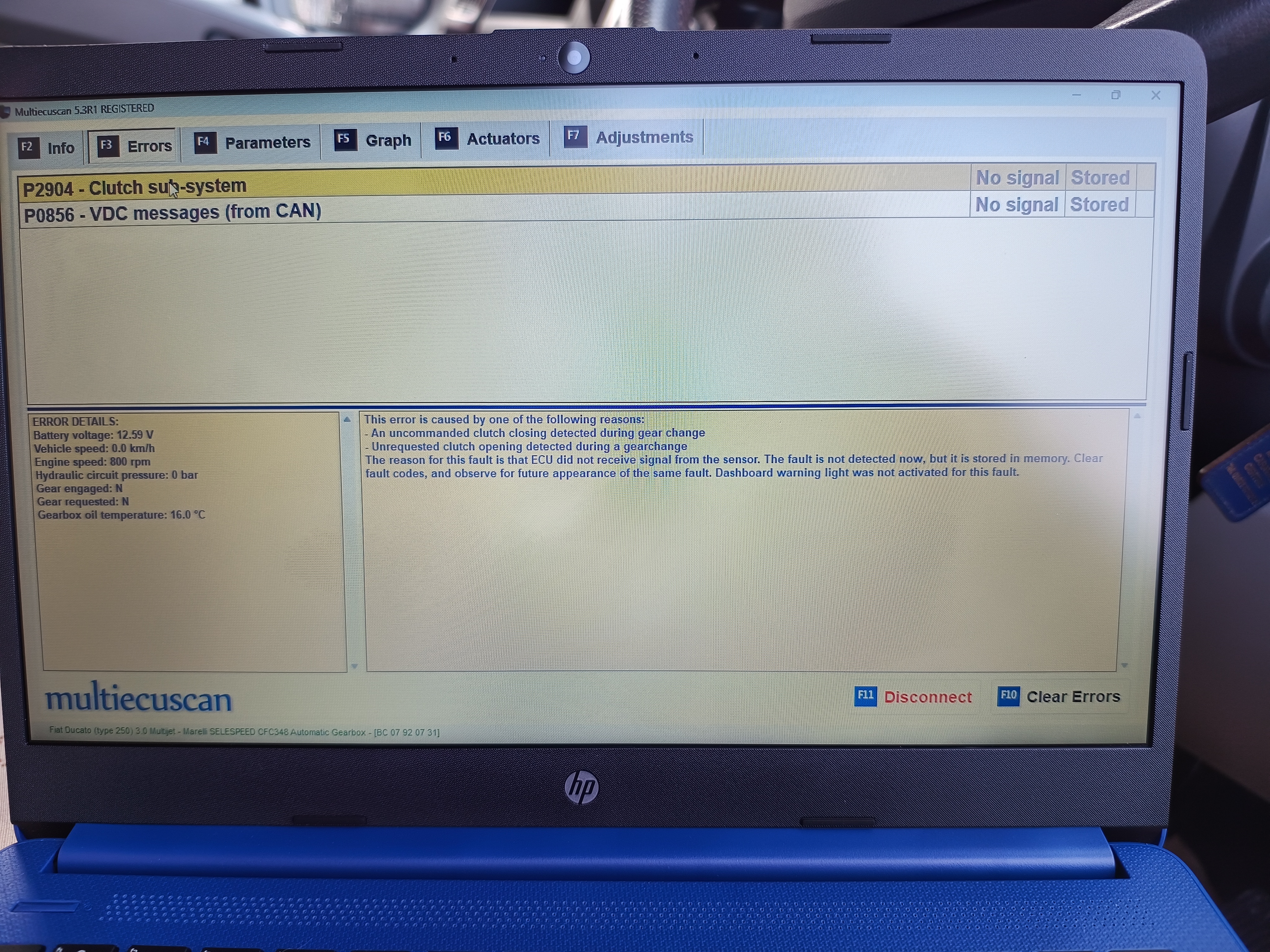

Hi I have now invested in MES when checking the gearbox ti comes up with two fault codes P2904 andP0856.
It says the reason for this error is that ECU did not receive signal from the sensor.
Can anyone tell me what sensor or connection to it is at fault and where on the gearbox is it fitted?

Hydraulic circuit pressure should be from 30-something up to 40-something (I don't remember the exact values) Bar, not zero as your screen shows. Worth investigating.
Just guessing:
I had the impression that lack of hydraulic pressure would prevent the start-up enable relay to activate and hence the engine would not start. But your display shows engine speed 800rpm…
Perhaps activation of the start-up enable relay is ”hardwired” to the pressure sensor and there is sufficient pressure in the system, but the signal from the sensor does not reach the ECU?
Or perhaps, since I assume it's freeze frame values shown, was the pressure OK until gear change was requested and then dropped suddenly to zero? That could indicate a faulty pressure accumulator.
It would be interesting to see a recording of all parameter values (MES normally saves a file with all values when you use the Parameters function and select All). Sequence: ignition on, start MES and select all parameters, wait 30 seconds, start engine, wait 30 seconds, request gear change, wait 30 seconds, finish.
