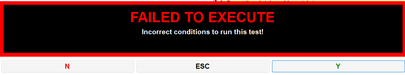

I tried to do the neutral position learning with MES and it failed (it told me the condition was no OK, my car was OFF, MAR ON...), it tried with ALFA OBD using the good ECU and it told me approximatively the same " values are outside allowable range" ( yeah, i was in neutral position).
