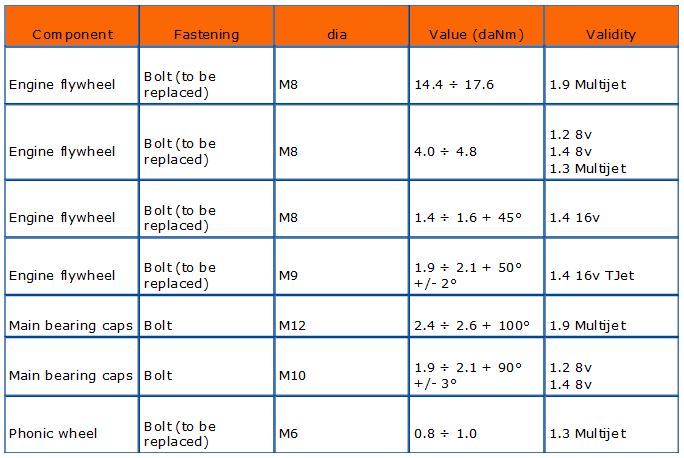

S Stemh New member Joined Jan 22, 2017 Messages 26 Points 4 Aug 7, 2017 #1 Hi, just wondering if anyone has the torque settings for the clutch and dual mass flywheel bolts on a 2009 Grande Punto 1.4 T-Jet. Thanks in advance!

Bernievarian Prominent member Joined Jan 15, 2017 Messages 2,993 Points 655 Aug 7, 2017 #3 Here's the table from eLearn... BRs, Bernie If someone here helped You fix -or better, understand- your issue, hit the thanks icon @ bottom right corner, it's free and makes us feel helpy ;-) Attachments Flywheel torque.JPG 67.4 KB · Views: 2,903

OP OP S Stemh New member Joined Jan 22, 2017 Messages 26 Points 4 Aug 7, 2017 #4 Brilliant, thanks a lot for that! Seems really low to me but must be right! Cheers
A aurick86 Established member Joined Sep 14, 2009 Messages 2,068 Points 460 Location Bucharest Aug 7, 2017 #5 Yes they do seem low, but they are only M8 bolts, even tho they are high tensile bolts they are still easy to snap at that thickness. They should have thread locker on them ( there are plenty of vibrations there)

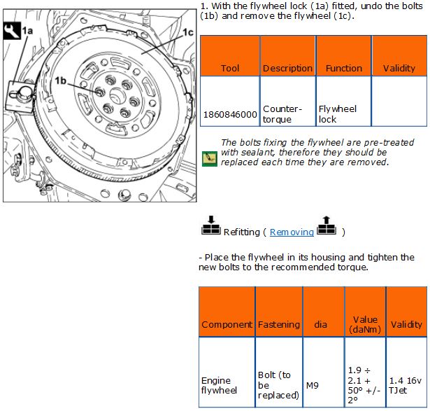

Bernievarian Prominent member Joined Jan 15, 2017 Messages 2,993 Points 655 Aug 8, 2017 #6 Here a bit more of info ... BRs, Bernie If someone here helped You fix -or better, understand- your issue, hit the thanks icon @ bottom right corner, it's free and makes us feel helpy ;-) Attachments DMF removal.JPG 77.2 KB · Views: 4,876
