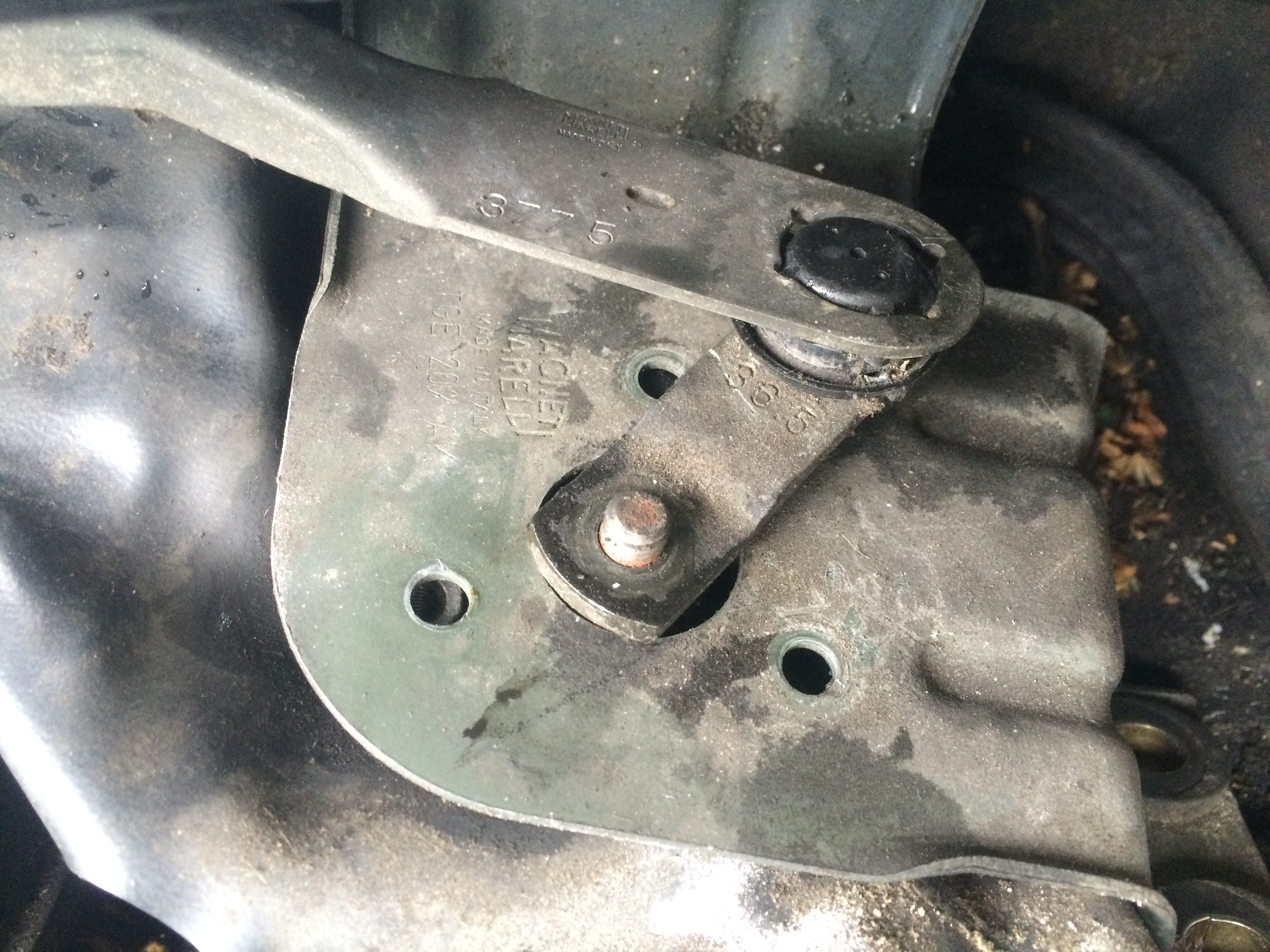

I need a new motor, but first I have to get the old one out.
How do I remove the crank from the spindle? I can remove the nut and washer, but it won't come off. Is the crank arm threaded too, or do I just need to exert more pulling force? If the crank is threaded, and I try to unscrew it, won't I damage the nylon worm gear?

I do not mean the wipers; I mean the crank on the drive spindle of the motor itself, which by linkages actuate the wipers. It is a flat rectangular bar with a ball-and-socket connection to the linkage at one end and the motor output shaft through the other end with a securing nut.
It is extremely difficult to access - you have to remove two panels, unbolt the linkage anchor, remove the wipers completely and them manoeuvre the motor/linkage assembly out sideways through a narrow gap. Only people with a shorted motor would ever need to do this.

Thanks; but oh dear - it seems I am STILL not being clear enough.
I am talking about the motor - any amount of levering the wiper blades would be pointless - no force would be transmitted to the motor crank which is 50cm away through two ball joints, and in any case I have already removed the wipers without problem.
I do not think the motor spindle is tapered, or splined as far as I can see - the crank is only about 2mm thick.
Only someone who has removed the motor to replace it would understand what I am talking about - it is not visible and is not something you would ordinarily have to mess with.
Thus: I have the nut off the spindle.
This is Fiat parts 9944295 and 9944296
The crank won't fit through the hole, and so can't be manoeuvred out - it has to be removed from the spindle. The other end of the spindle is the motor nylon worm gear which obviously could be damaged by any force.

Thanks - that's all the information I needed - with a pipe-wrench I wiggled it off quite easily. However, not easy to see when it is assembled, which is why I thought it might be threaded.
