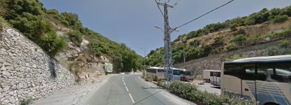

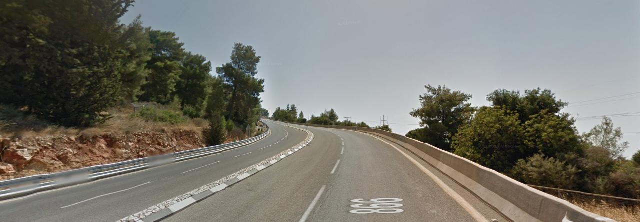

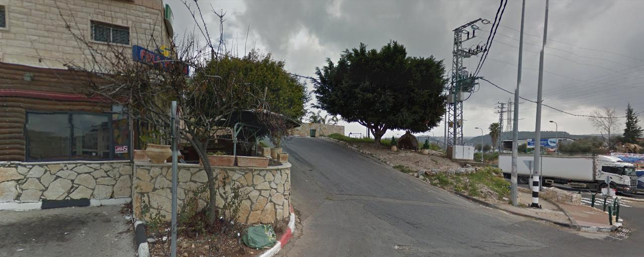

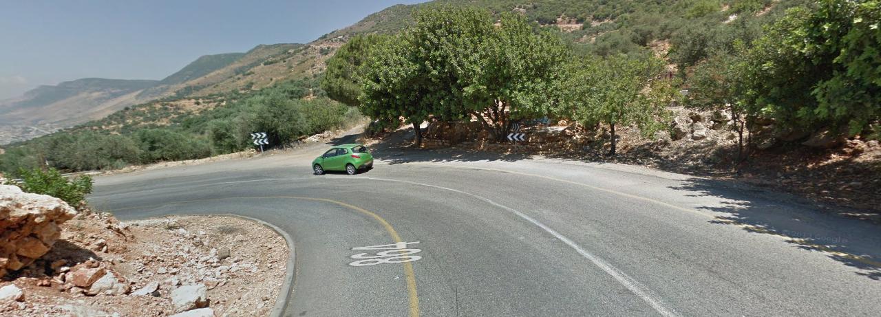

Roads
I live in the north of Israel. Most of our roads here are on an incline, sometimes modest incline for long sections, sometimes sharper inclines combined with a turn. In the attachments are a few representative pictures of the latter. (It is virtually impossible to express the exact incline of a straight road using pictures from Google, but i guess you may figure out what the road is like)
I do want to be able to drive reasonably well on those roads - 75+ Km/h on a straight and somewhat inclined uphill road, 60+ Km/h on smooth uphill turns, with some margin for reasonable maneuverability as much as the road allows, without hitting a power limit or overloading the engine
