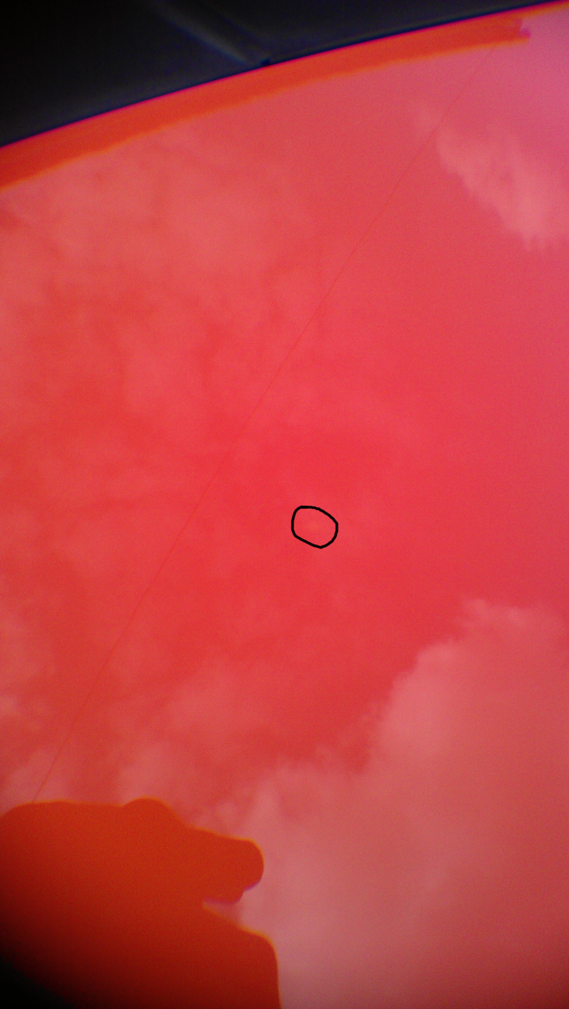

Now for this i concntrated on one little chip on the bonnet no less.
as you can see its a nice little chip to try this out on. 1st i did was cleande the area. The car was washed yesterday so as instructed i used the blending solution to clean the area further. I then shook the paint well and placed a blob of paint on the chip and waited about 5 minuits for that to dry.

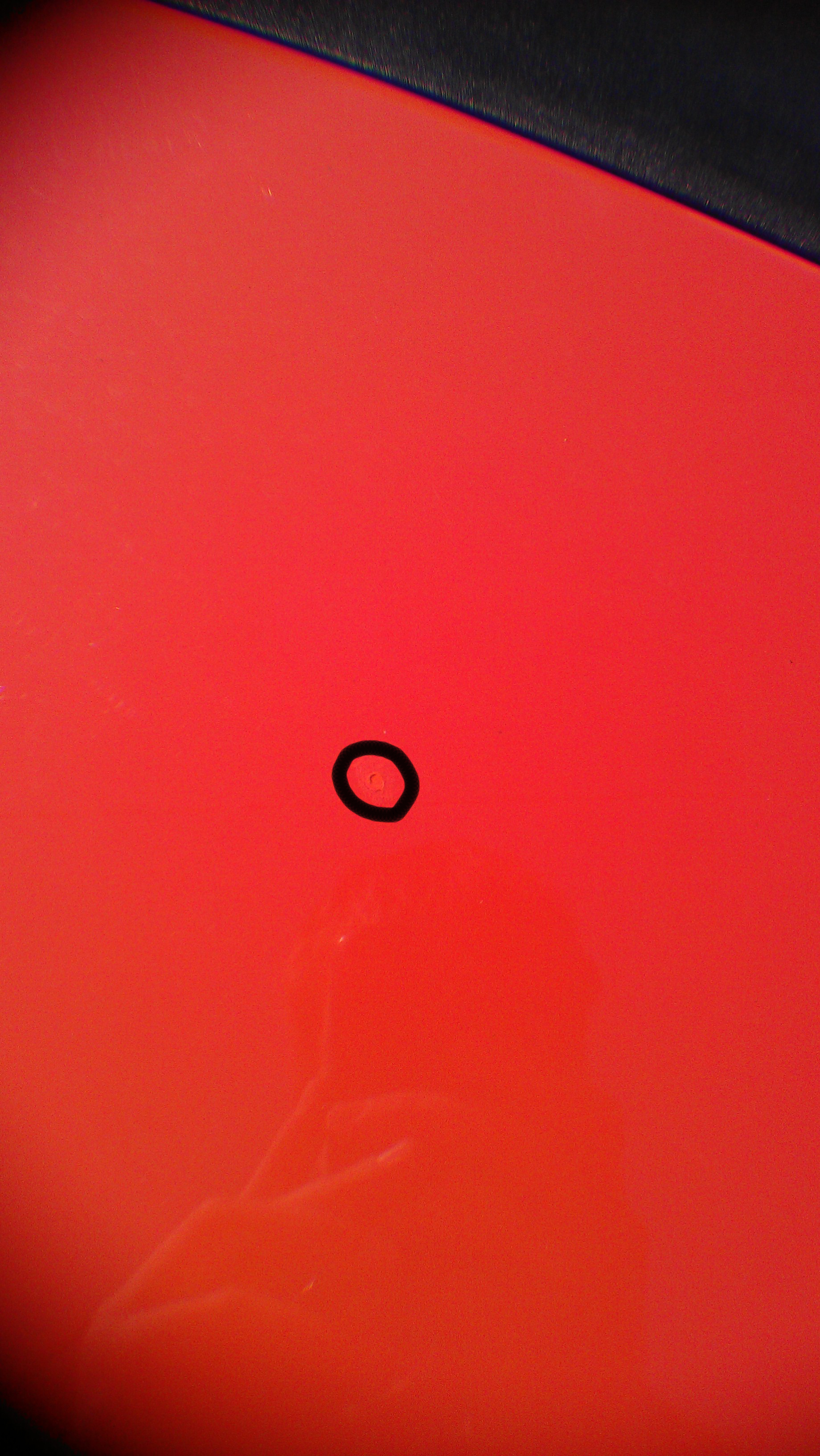

As you can see the chip has been filled in by the paint. I then used the blending solution and cloth to "blend" the chip basicaly it levels of the chip to be level with the rest of the paint for deeper chips a few blobs of paint can be applied as paint shrinks as it dries.
After the blendind solution I polished the area with a micro fiber cloth and the supplied polish this is the reasult.
Now i took these pictures with my mobile and there not perfect. But as you can see it has made an improvement. Now i wouldnt say the mack was 100% accurate but that is very hard to do with an aftermarket product and I belive my bonnet has been resprayed in a former life so will have to try some other parts of the car to see.
Overall i am very impressed with the reasults. Im the kind of person that will use a touch up brush and wet and dry paper only to make the chip worse but with the chip ex kit I have recived better reasults in less time and effort.
