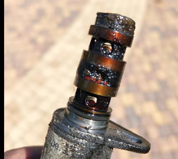

First of all, check the easiest thing, like VVT solenoid valve. Is it clean?
VVT wheel can be full of dirt too, but it requires disassembly, so...not easy.

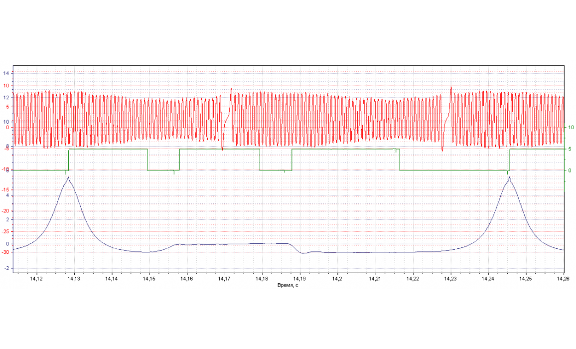

The VVT operation. You'll need oscilloscope to grab the signals. This is real Diagnostics (not parts swapping).
