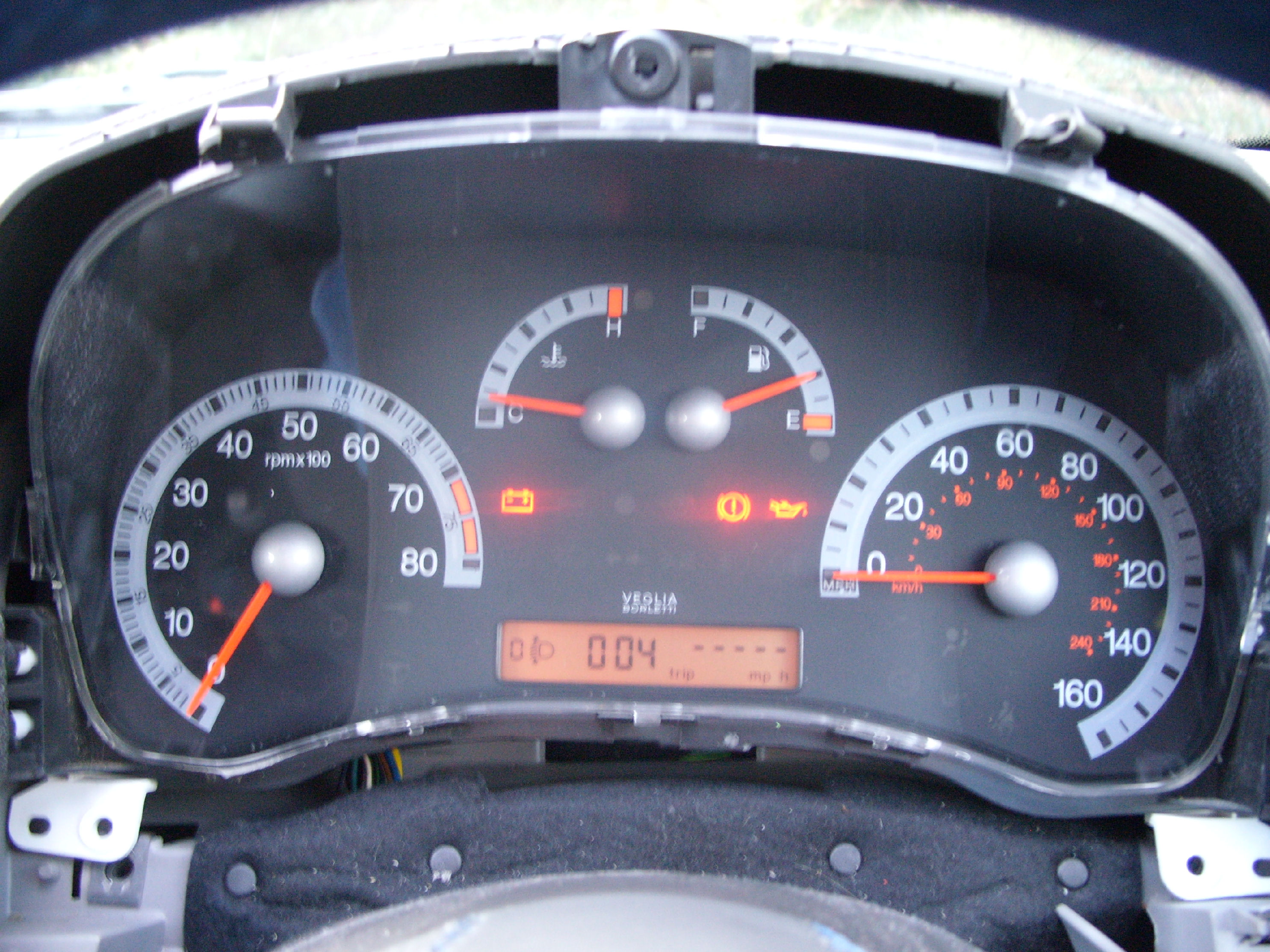

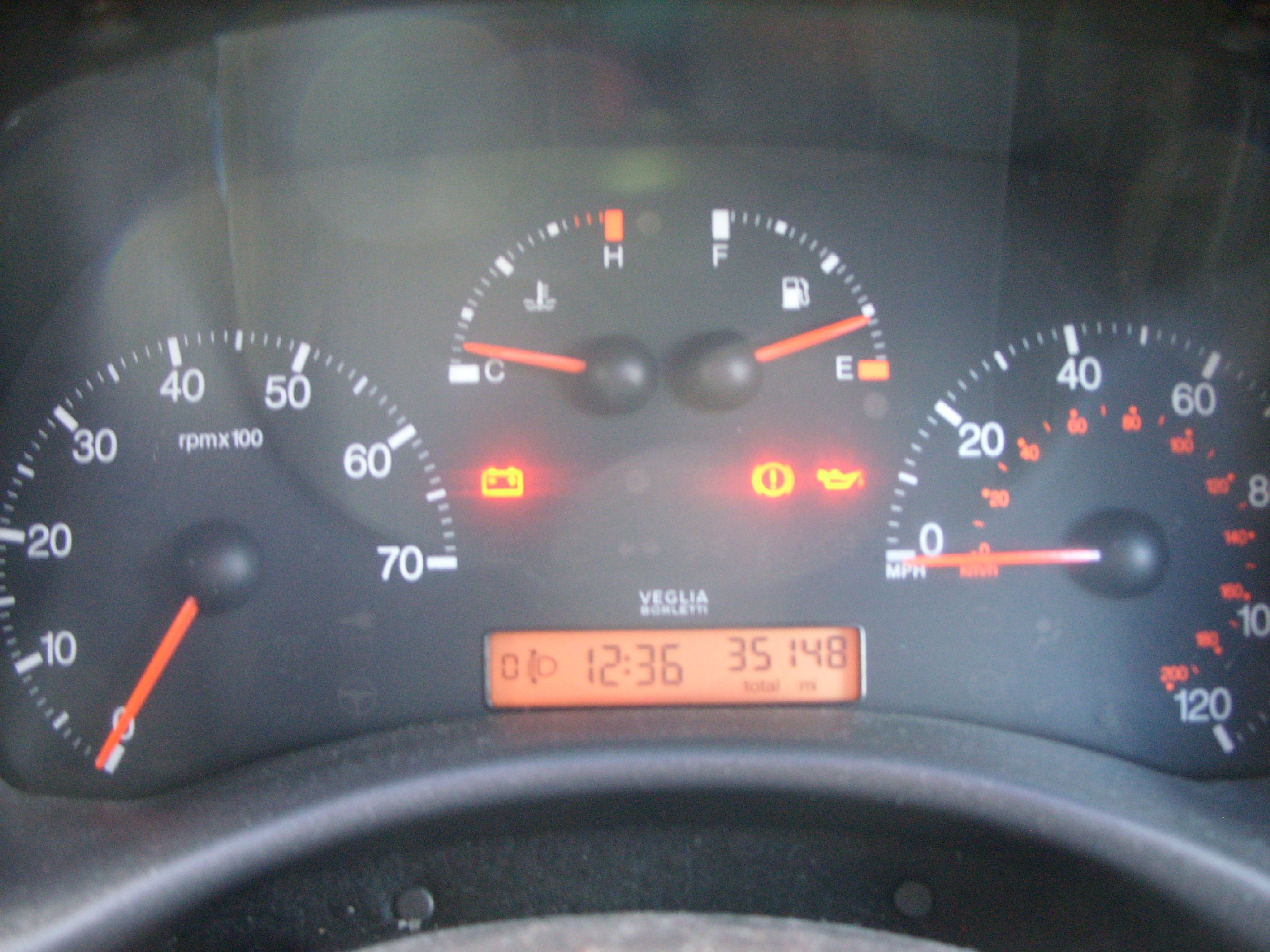

here's my two; one from jtd other from hgt

all mk2 speedo's will fit all mk2's
just make sure the new one has lower mileage than yours then get it aligned at fiat dealer about £60
The One on the Left is the one i sort of fell in love with
I dont know what it is about Rev-counters but i just like them :)
