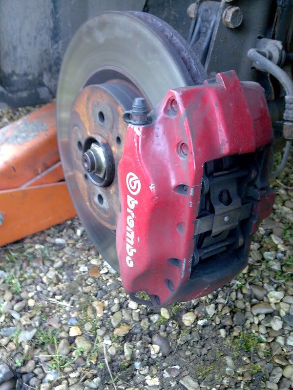

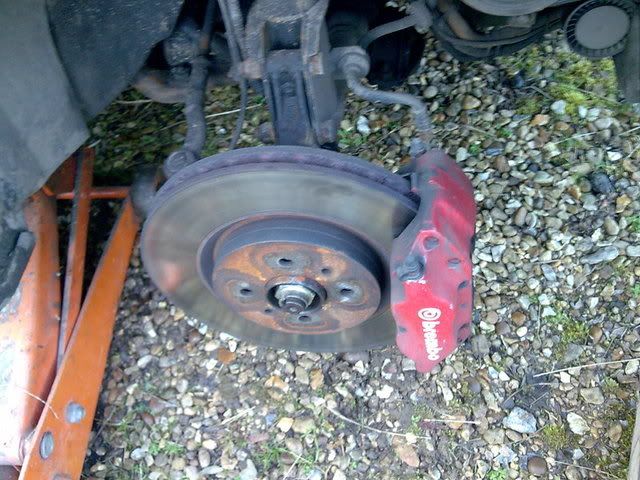

I have fiat coupe breaks on my bravo but the rest of the front end off a coupe to folow.
On the JTD it has the same hubs as the 1.8 which are more than capable for the JTD.
I'd suggest the rear break conversion if you want an easyish improvement.
Ultimately if you want it to just STOP... fit the coupe brembo's, but you will need to make adaptor plates for the wheel hubs.
