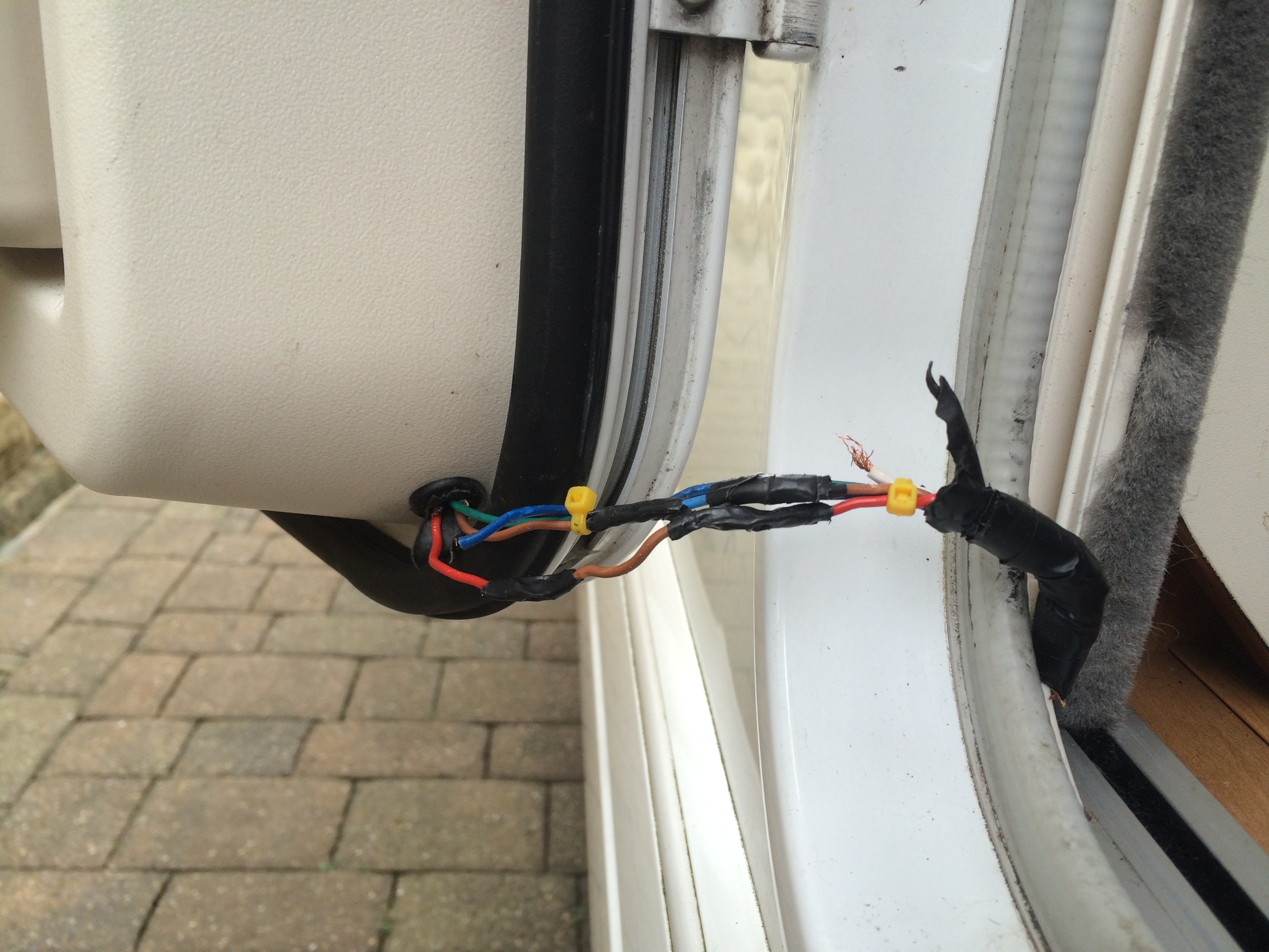

Hi, does anyone know where I can get a wiring diagram for the remote central locking for a Ducato Motorhome habitation door
What is the part number and where can I get a spare?
Judging by the type of wires used, you may need to contact the motorhome conversion company, looks more like household mains wires than auto, 99.9% sure it's not a Fiat part
If it's made by Swift, then your best bet might be a Swift dealer for a new harness. Again, if it's Swift, they used to give wiring details in the owners manual or documents supplied with the MH.
...it would certainly help if you posted the model and year of your 'van.
It is pretty certain to be converter (rather than FIAT) wiring, and on-line information exists for some of these (particularly Swift Group and Auto-Trail), but varies by year.
To quote HRH " That wiring looks as though it was done by an I....an"!!! That is terrible wiring if it's original, I some how doubt that it is original as it should be in a flexible conduit for a start, It is most certainly not a Fiat loom anyway. I know in my Rapido the wiring is a total mess and it's original, or at least it was until I got to it to try and put some logic into it. I had 3 red wires running the length of the van with no ID on any of them, a lot of the wiring is ordinary domestic cabling as well, could not find any wiring diagram anywhere either. The best bet is to open the door itself and renew all the wiring from the lock right through to where it joins the rest of the locking circuit inside the van.
