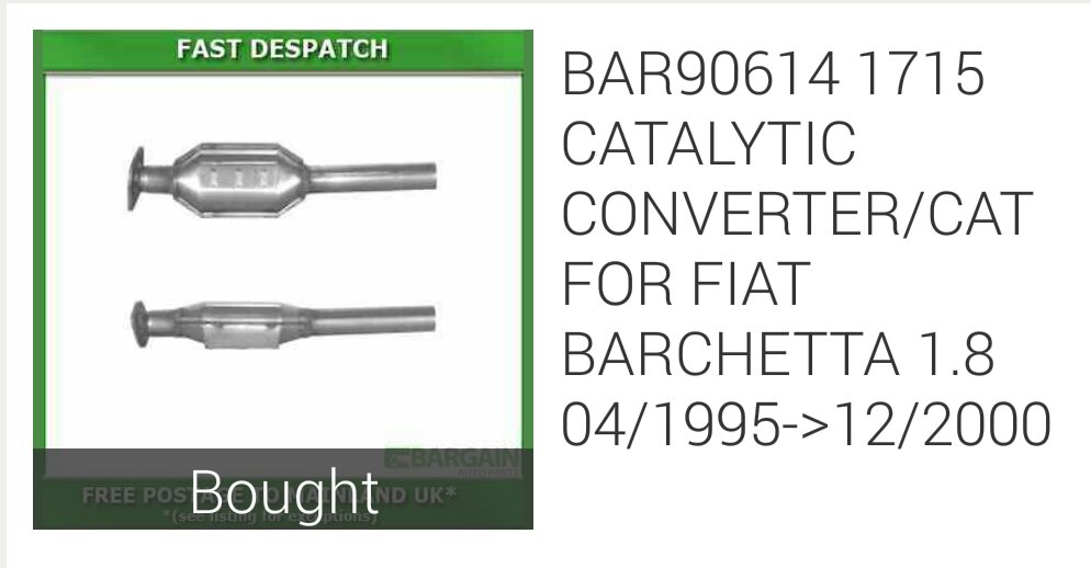

Hi. I just purchased and fitted one myself from eBay. No thrills. Felt robust enough for me. It passed the emissions test today. It is suitable for my application. Also a low mileage user. Details attached.
