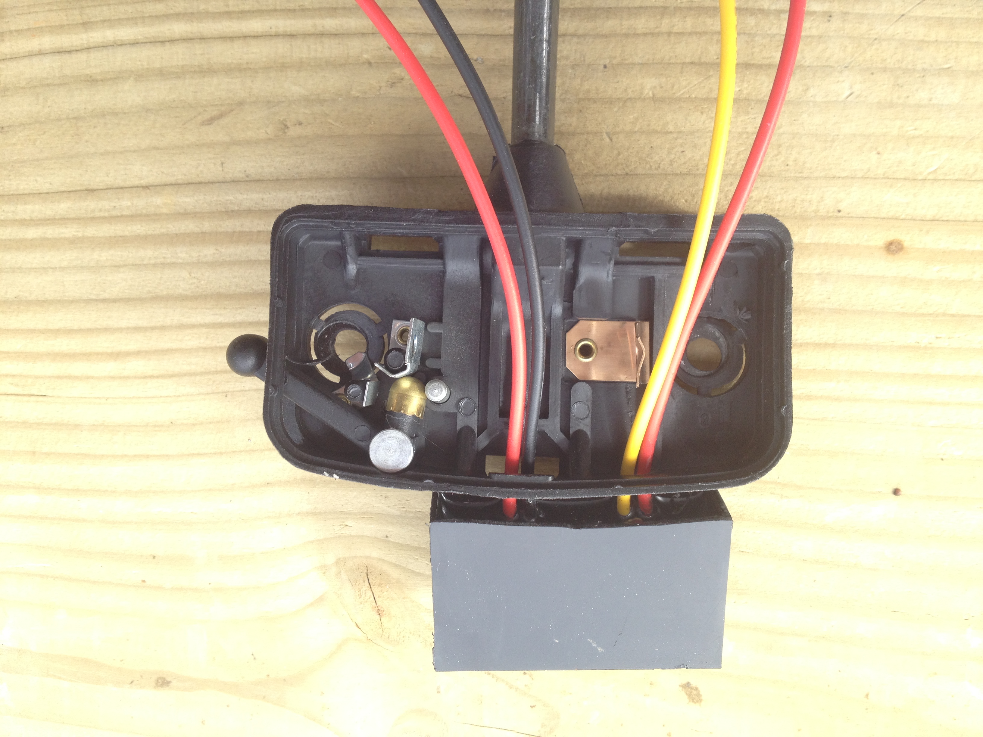

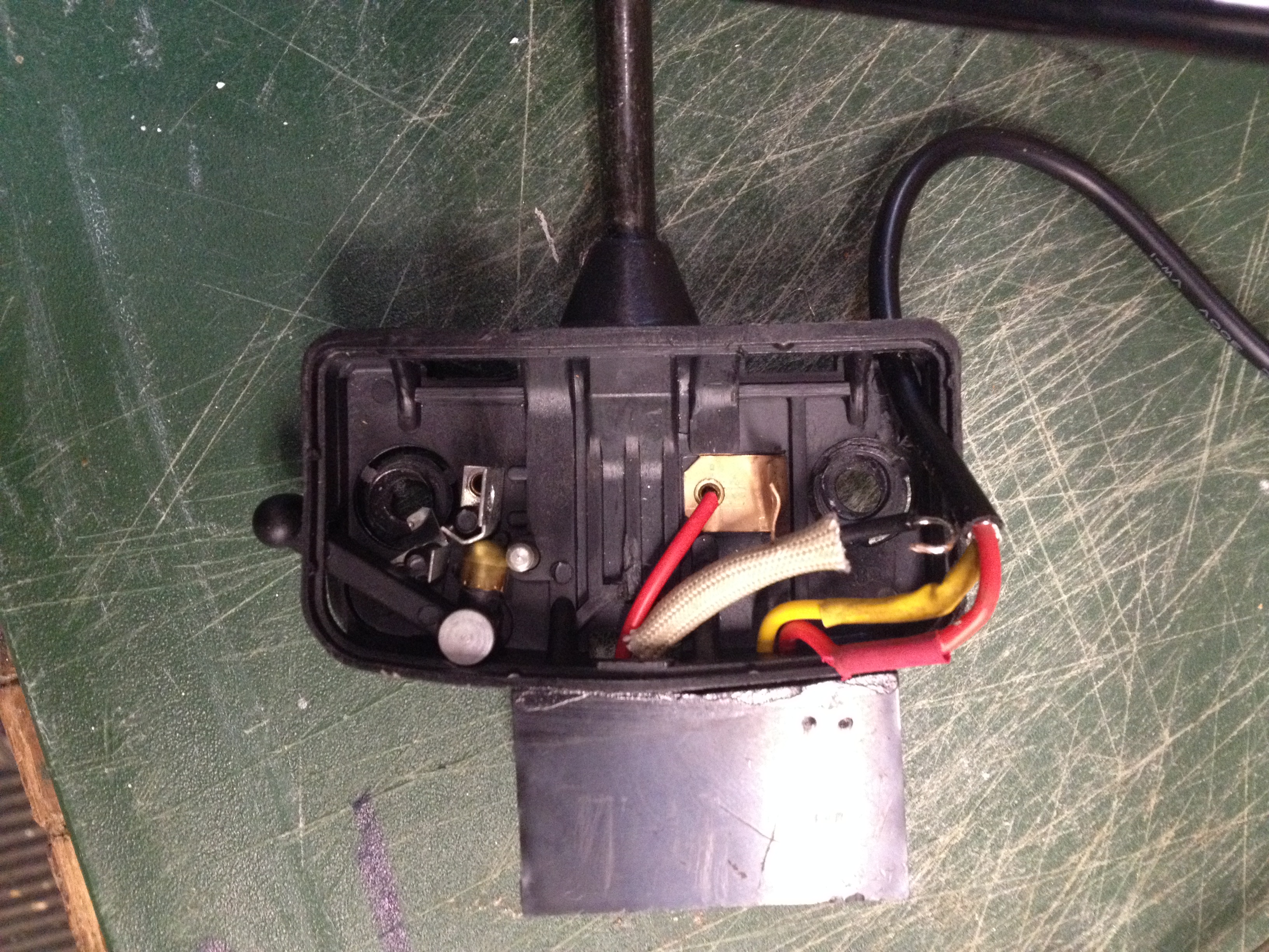

The inside of a Fiat Panda interior light doesn't have a lot of high tech about it. Following dragonMan's advice I took a 12v +ve from the interior light feed, as the camera has it's own on/off switch.

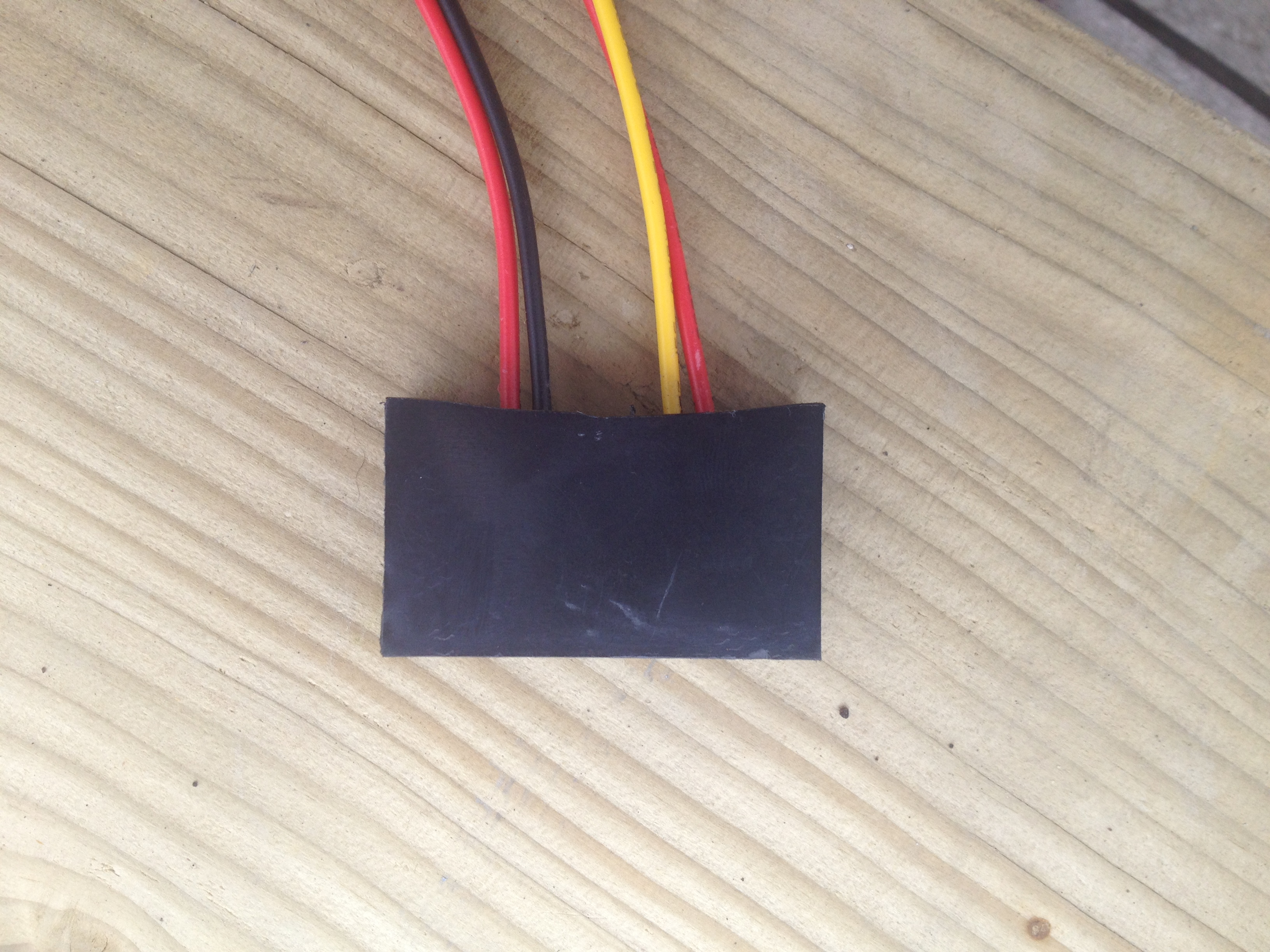

I shaped the potted dc:dc converter to make a better fit for the curved side of the interior light and marked it up for drilling.
After some measuring, gluing, soldering, heatshrink and sweating, I had a thing that should provide a tidy feed for my video camera.
Everything back in place, the only remaining check was that the lead snaked to the right place without getting in the way and the interior light still works.
