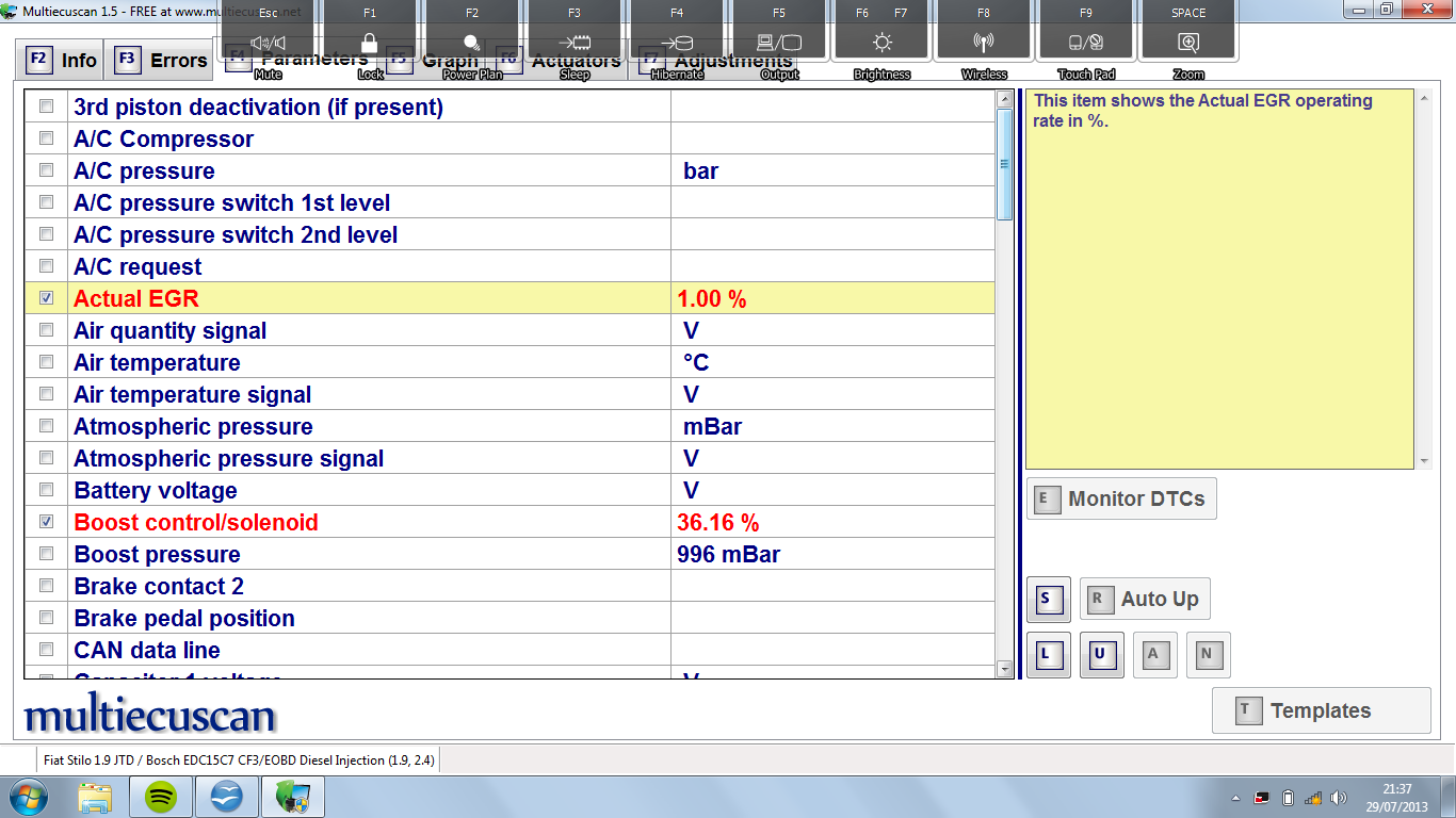

Hey guys. Just plugged in the car to check some error messages. 3 cleared one remains as the AC has no gas in it.
However, I checked the BOOST VALVE with the car running and under FULL load it drops to 36.16%. I'll be honest and admit that I have no idea what this means - but maybe someone else could shed some light?
Image and graph export attached.
** EGR is blanked off so I assume this is why it's at 1% **

As for the Boost Solenoid issue, im no expert so I cant really comment, but if its dropping then that may be a sign its sticking - again im not 100% on that. Try this guide with regards re siting it, because then you can have a look at the general condition-its a common fault on these cars due to the position and they get wet, the moisture stays inside and cant dry out and so they die slowly.

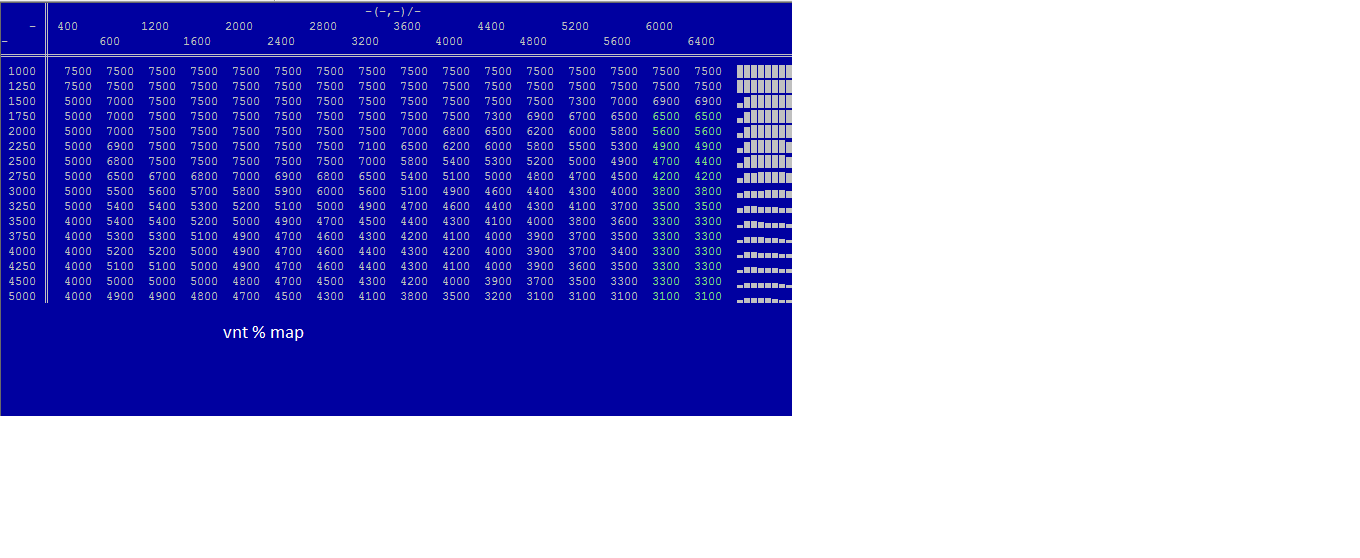

if like the later 16v jtd, the boost solenoid should probably be around 75% at idle which is max spool position then say when full boost the % would reduce down to reduce boost pressure as fueling increases 20% being the min amount(trying to reduce boost )
there is an open loop and a closed loop control for vnt% , to a certain fuel mg value it just reads off vnt map value and sets vnt to value, above this set point it moves into closed loop and then uses boost pressure as a feed back value to control vnt%.
in that shot above boost is not ticked?
try a log when driving 3rd or 4th gear, get to 2000 revs and floor throttle and log as high as it goes or 4000 if you can.
you may see vnt% increasing but boost not increasing= problem
log boost and maf airflow if maf shoots up but boost doesnt probably a boost leak somewhere.

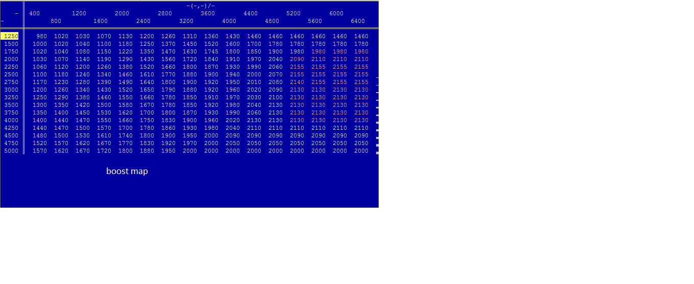

then post log here and ill try to find a vnt control map tonight to see how it compares.
log revs , desired boost, actual boost and vnt%
