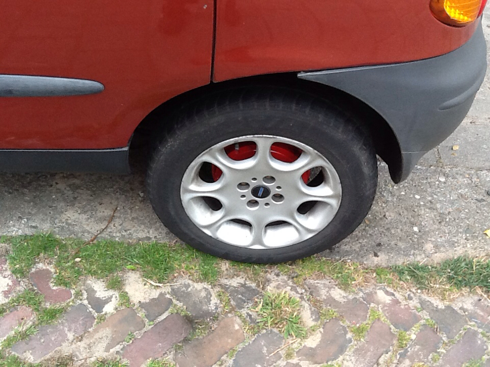

ImageUploadedByFIAT Forum1397829926.180008.jpg succeed to get it back on, I took the shoes off, twisted the handbrake thing a little bit back, re assembled the brake and the drum was put on without problems :)
