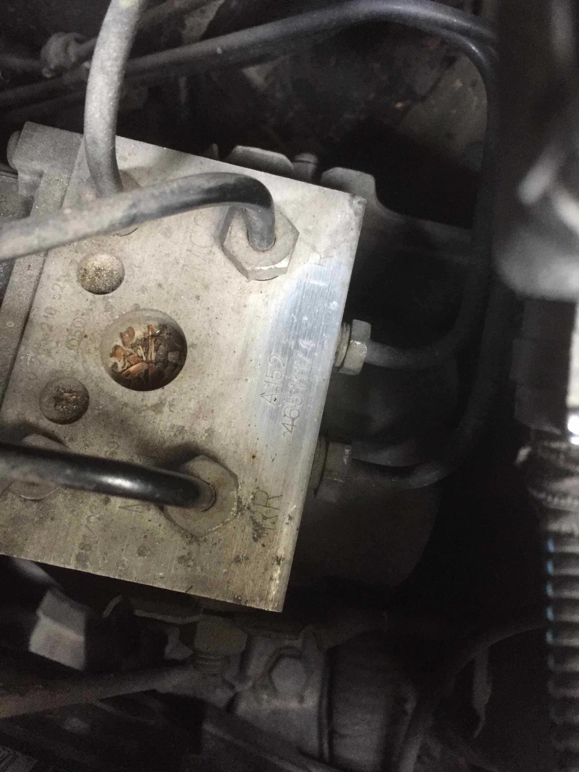

Got one part of the info, the pump type is on top of the ABS pump block on the right - only visible after a good scrub wi' the green scratty thing, but legible as punched in. in the case of the 1998 105JTD and the 2000 105JTD the block id is 46511174 if anyone needs this - I'm hoping it's the same for this range of vehicles but don't quote me
