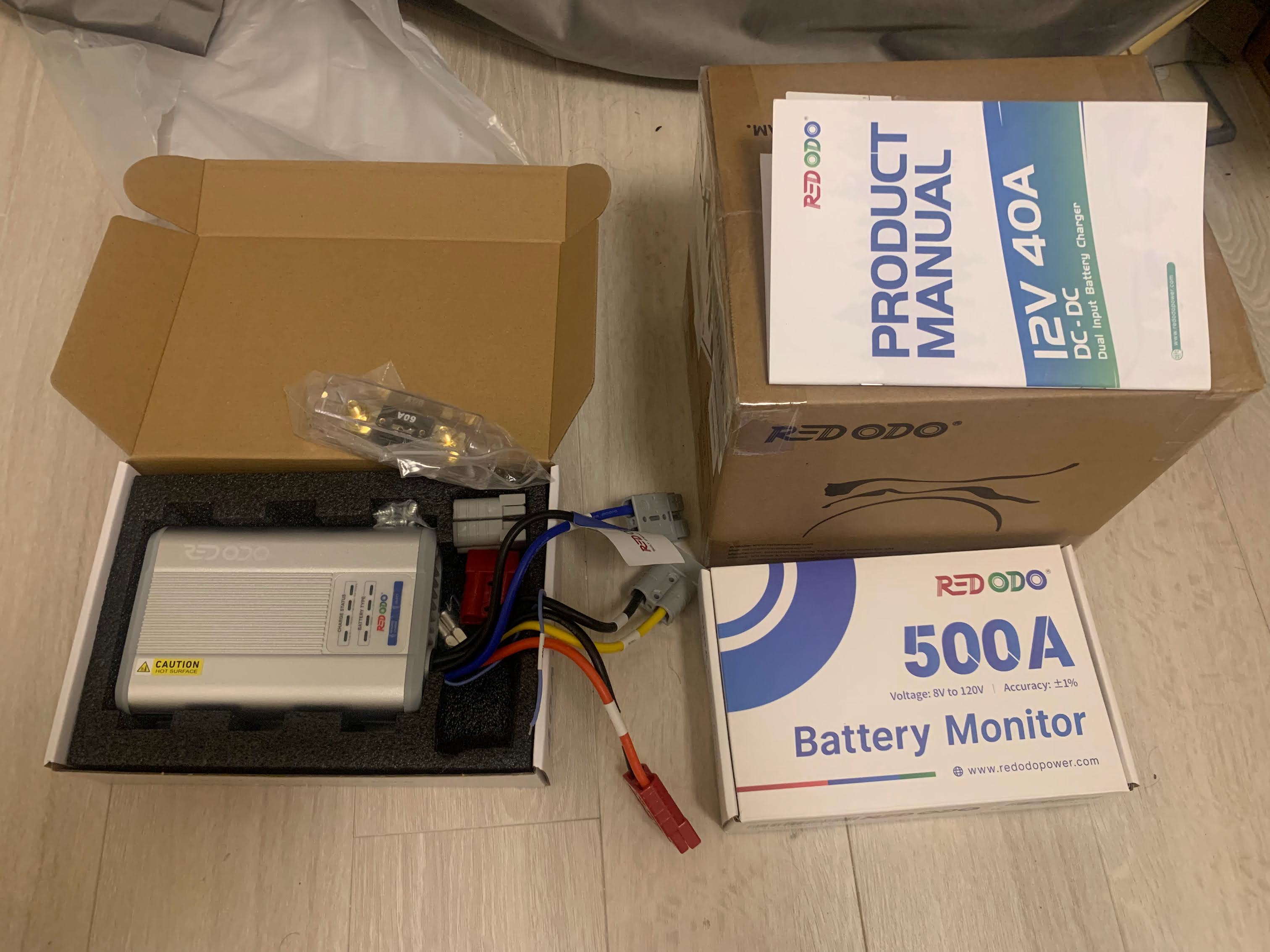

It is true that, considering the power used by the starter motor and vibration, I don't think a lithium-ion battery is very suitable.
I would like to consider replacing it with an alternator.
However, the capacity of lithium-ion batteries is very superior to that of lead batteries, so I would like to consider using them as a sub-battery.
