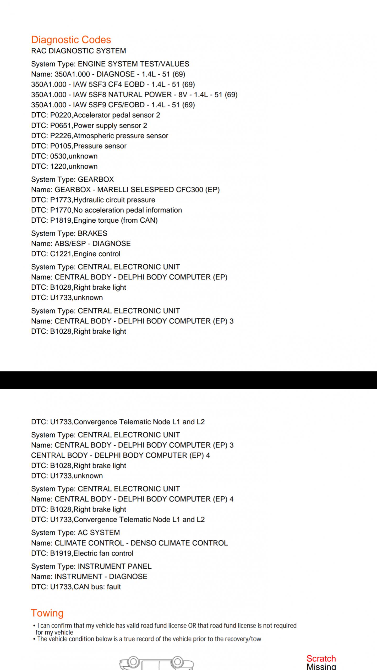

Last night my car gave up in rush hour traffic. The engine was still running but the transmission light and engine light came on and "check transmission" and "check engine" warnings on the dash.
RAC recovered me home and provided a readout of Fault codes. My initial reaction was "I need to replace he gearbox" and my car is a Dialogic so that will likely be stupidly expensive.
I was hoping someone with an experienced eye could take a look over these fault codes and either explain them a bit easier or give me an idea on where to start with repairs.
Thank you in advance!
Seems the dualogic controller misses informations from the engine control unit and therefore stopped working. It needs to know a bunch of things to actuate/release the clutch and select the right gear; Accelerator position, delivered engine torque, brake pedal, current speed, etc.

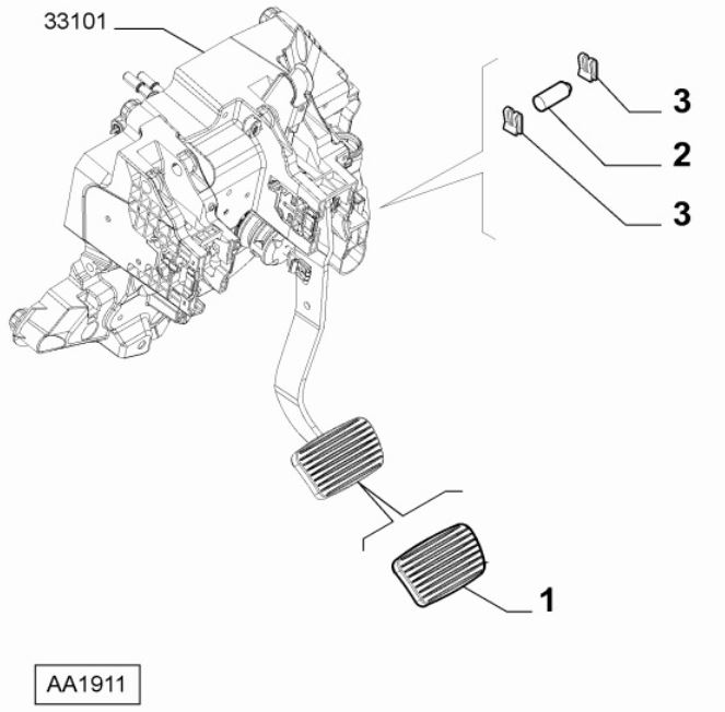

It's probably hidden in the pedal support and quite difficult to remove unless one know how to, which I don't … Maybe simpler to remove the whole block (or at least loosen it) so you can better see how it's fitted ?
Couldn't find much in eLearn & ePer but here's how it looks.

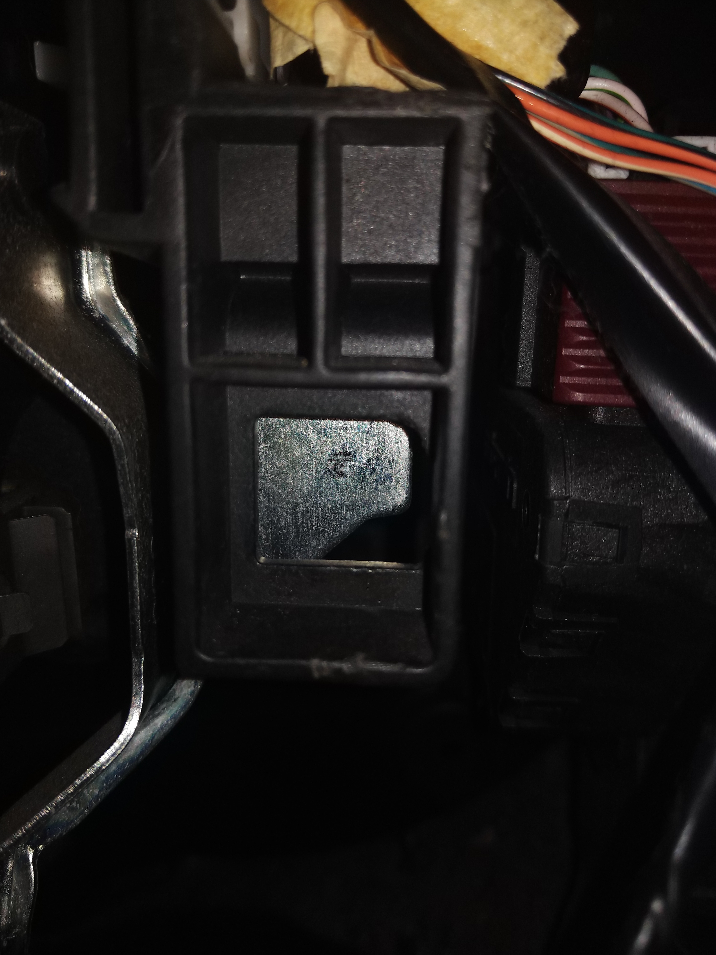

So after I removed some cowling to get a better view, I found the switch and removed it. Nice and easy and it popped right out.

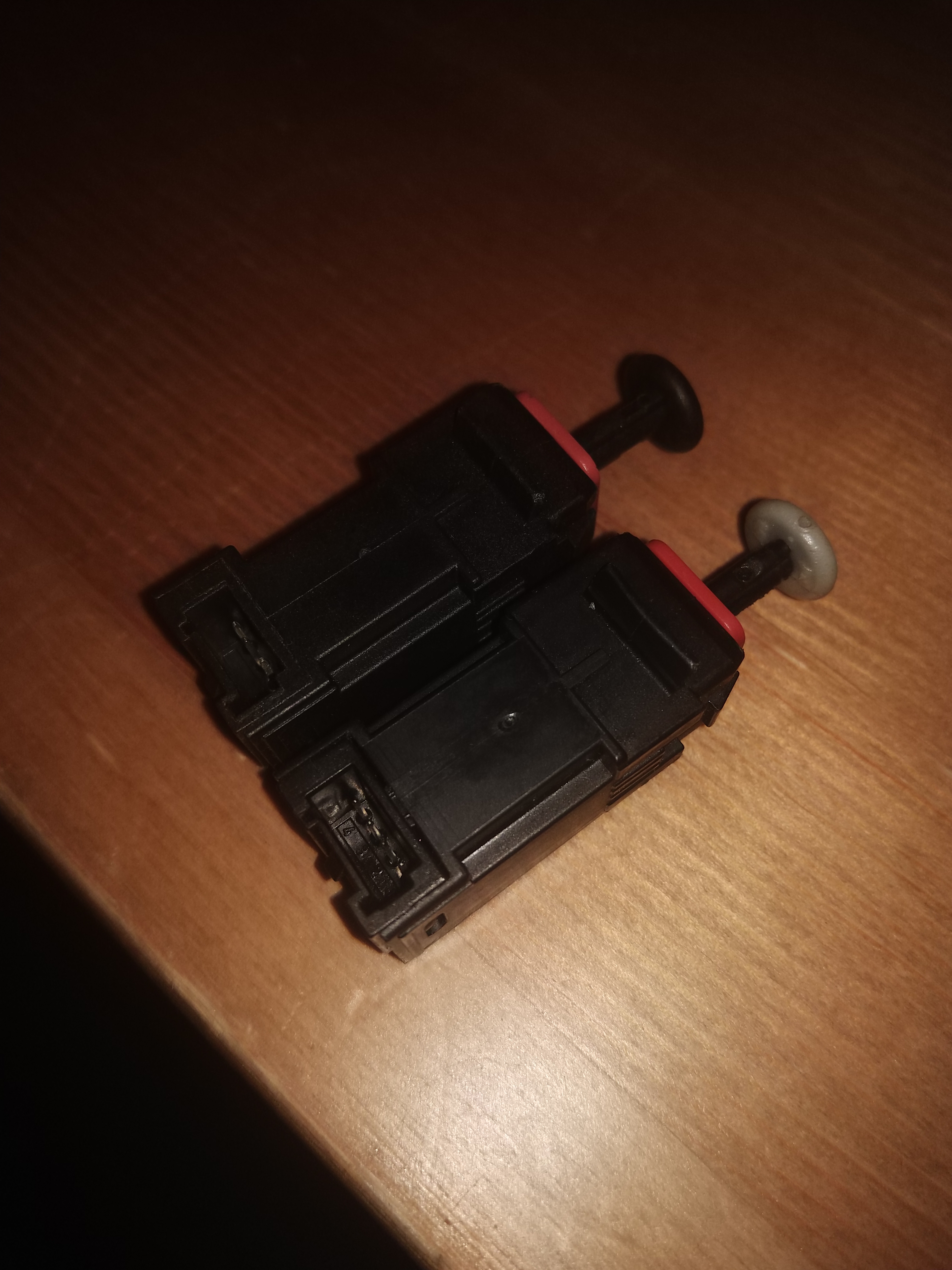

Went to ECP and bought an identical switch.

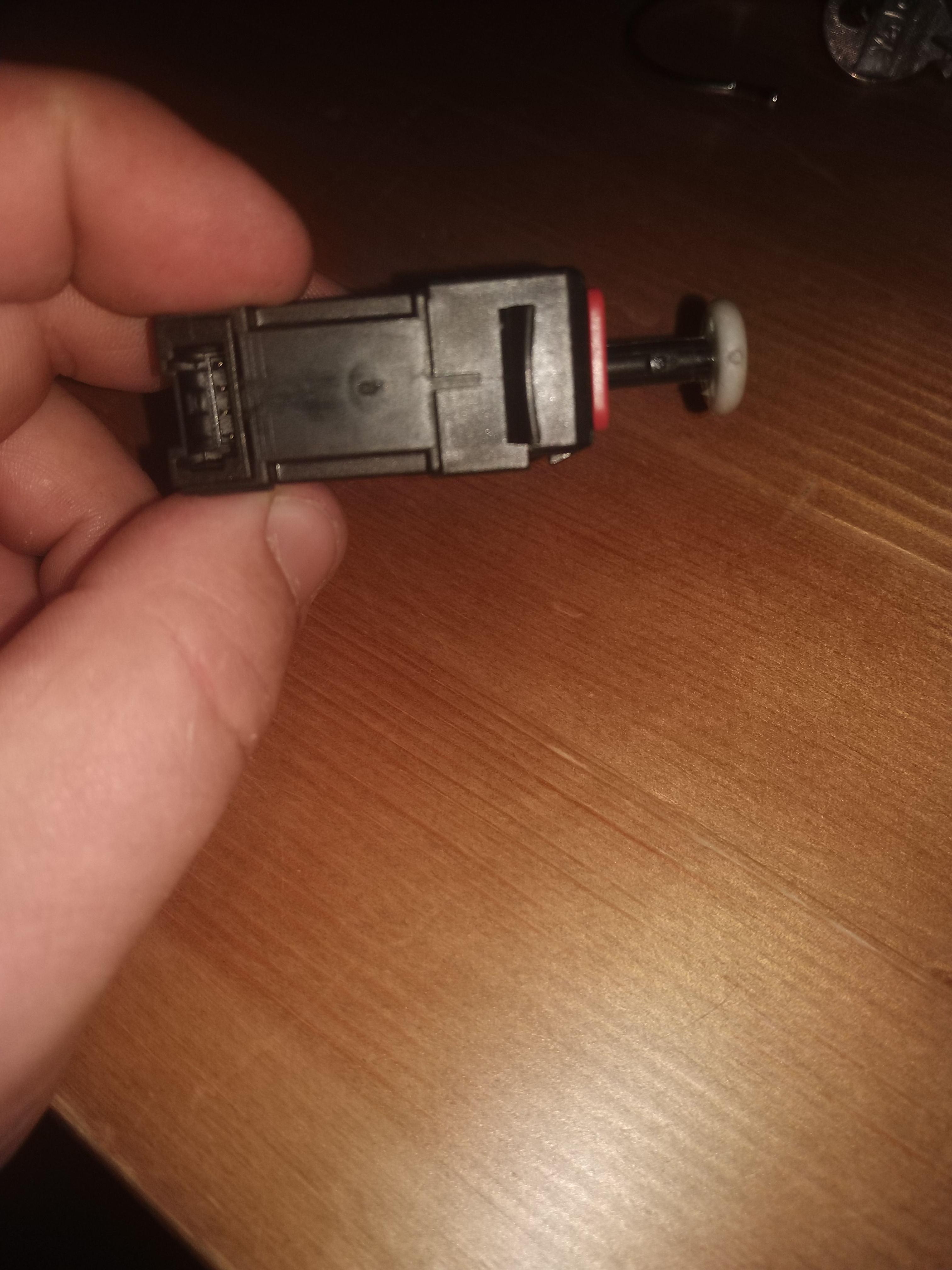

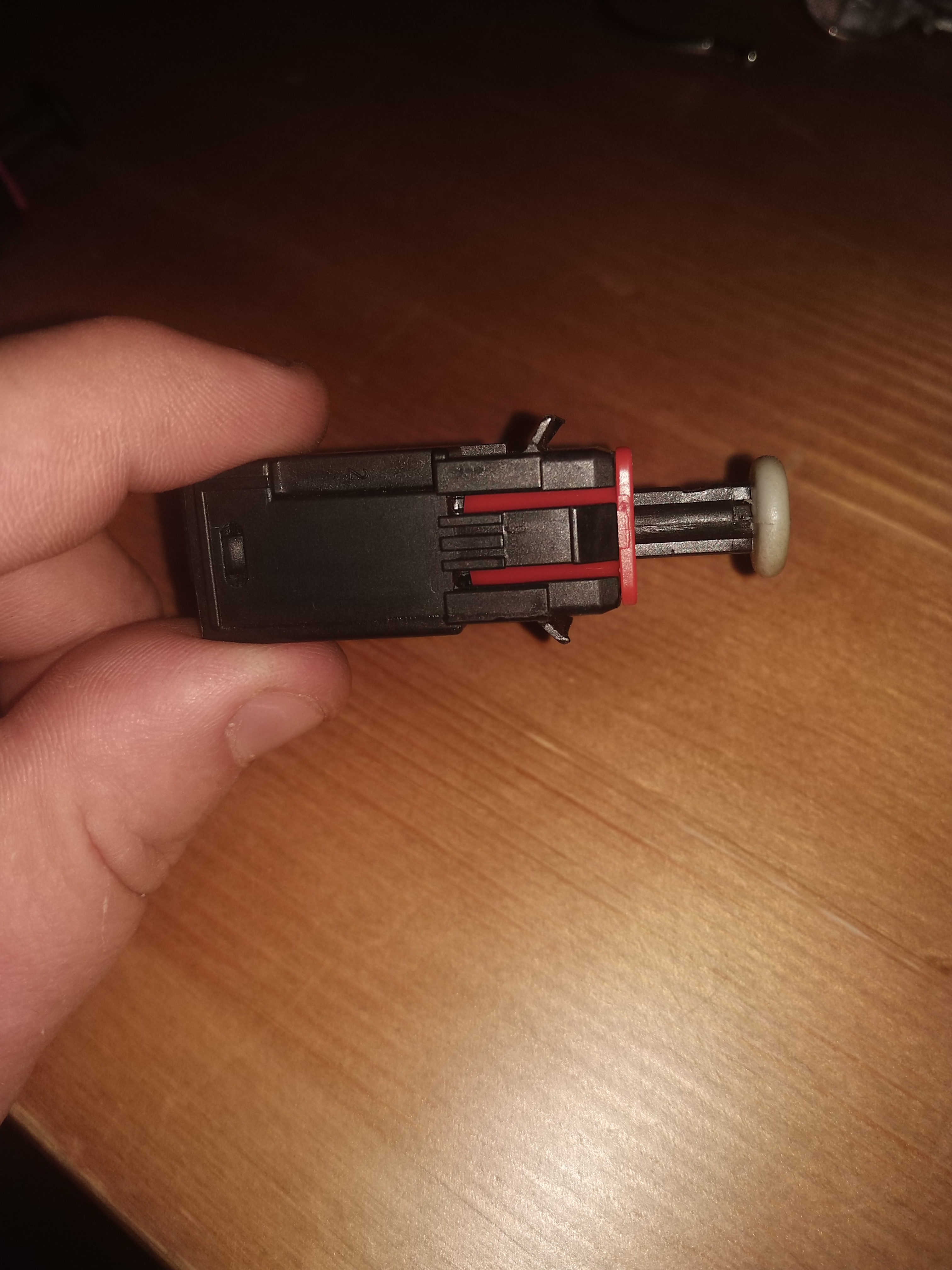

Now for the absolute ****ing life of me, I cannot get either switch back in! Both switches are identical. there's no threading or obvious way to stick it back in and secure it in.

I wonder from your photos whether it might be one of those fittings where the red clip pulls out i.e. to the right on your picture allowing enough movement to get the switch in place, then push the red bit back down. I might well be wrong - just an educated guess
Thank you DGPunto. I tried for around 2 hours and gave up in frustration. My better half managed to convince a local auto electrician to come out and he was stumped too. He eventually held it in place with cable ties and we now have brake lights!
A turn of the key and the car started first time! (It hadn't done before the the old switch was removed)
And then after about 2 minutes of idling it stalled and cut out and refused to start again. The transmission light has started flashing again and the engine light is on. He even scanned it for me and it threw up a bunch of codes but he didn't make note of them and just said various faults relating to transmission, CAN etc (he was giving his time for free)
I think at this point there is no other avenue other than a specialist garage for diagnosis :(
