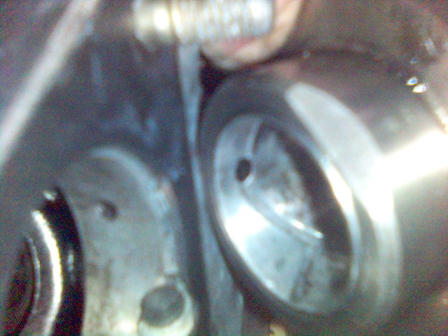

The end of the camshaft runs in the Bearing (right) which fits into the Cylinder head apeture (left). Common to both is the visible little hole from the oil gallery. These holes line up and keep everything lubed. For the record if this thread is used in future I was advised by Best Engines (York) - highly recommended for engine stuff - to spin the engine on the starter with the cam and belt removed. After a while I was able to see oil spurting out of the hole so hopefully this has sorted it.
Well I took the cam cover off and the oil pump spat out oil 2 metres in front of the car. :cool: That'll do for me. :D Whip the head off? The cat's starving, girlfriend hasn't seen me for 8 weeks. And still the TIPO doesn't work ! :bang:
