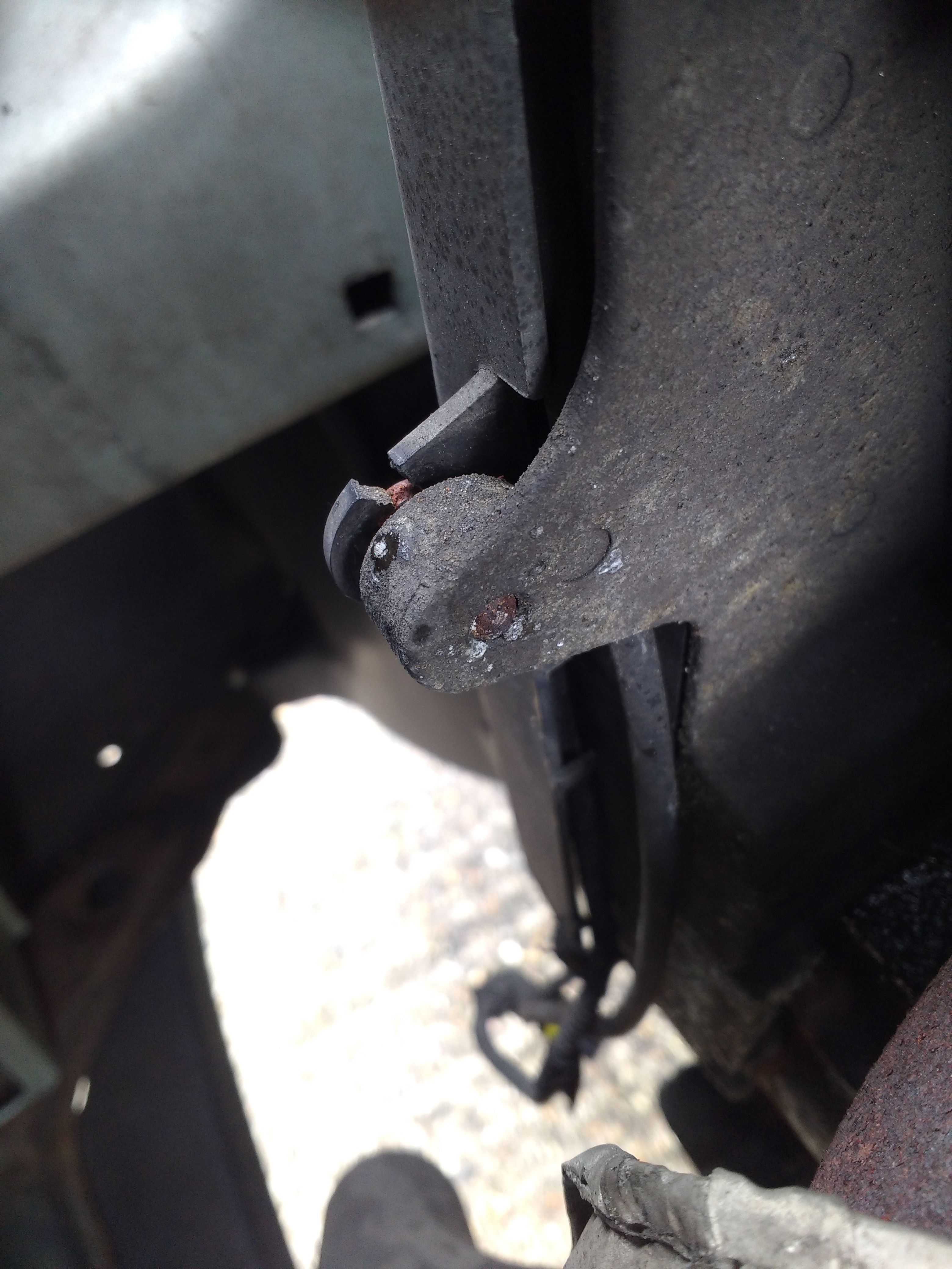

So I haven't actually changed anything yet, I was just poking around earlier to familiarise myself with the bits I'm gonna have to take apart.
When I went to undo the first bolt for the upper housing of the cambelt, it must have been rusted and snapped, with surprisingly little force, and parts of the lower housing secured by this bolt we very brittle and basically disintegrated.
I've tried to show in the pictures. My question is, that with the other bolts in place it's the housing is still on securely. Like I can rock the engine grabbing hold of the housing where the bolt is missing. Do you think I can get away with leaving this?

Wait a minute, I think I underestimated the task. So I have to undo the driver side engine mount, and take off the alternator belt and wheel?
1st off, for taking off the engine mount, I only have two axle stands. I'm assuming to support the sump the car would need to be lifted on both sides... So do you reckon I could get away with using my jack under one side of the car and the axle stands for the sump and the other side?
2nd, how on earth do you take the alternator belt and wheel off?
I guess I'm not doing this job today :p
no need to remove wheel or lift car on both sides
if you dont have hydraulic jack use trolley jack to support sump, put a piece of wood between sump and jack, lift it up and then undo engine mount
if you got aircon its a little play to but belt back on
I sorta don't trust just a jack holding the engine... I seem to have to go under the car for some bits, wouldn't want the jack to fail and an engine falling on my head.
Also I was thinking the alternator wheel was in the way of getting the lower cambelt housing off, but of course if I'm taking the engine mount off then it wouldn't be :eek: :D
