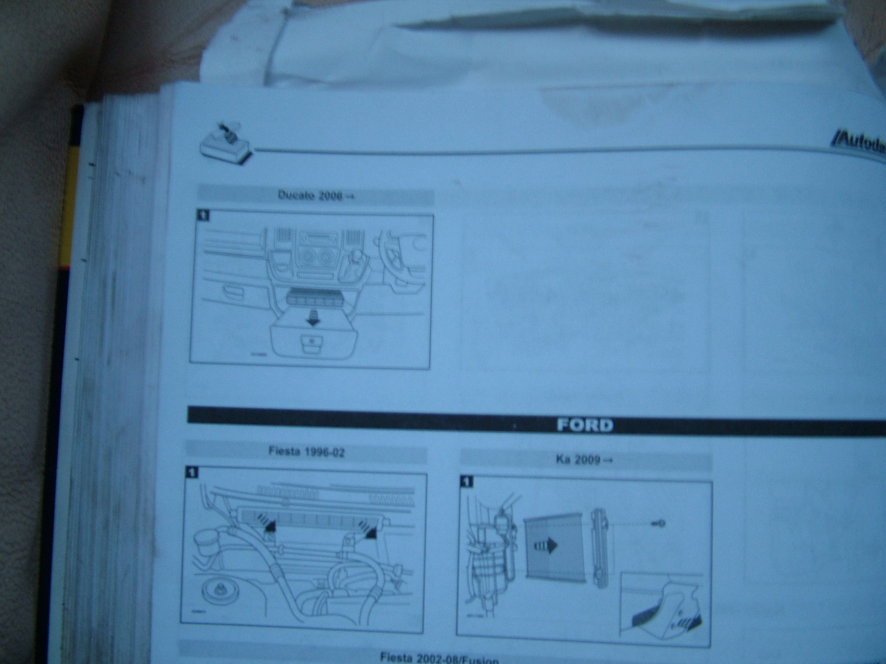

My Autodata only shows 06 on Ducato with pollen filter?
My 2006 x244 does not have a pollen filter. So given info from @bugsymike above, possibly only on x250 and later models from 2006 onwards. Have you tried the search function? I am sure that pollen filters have been discussed on a previous thread.
