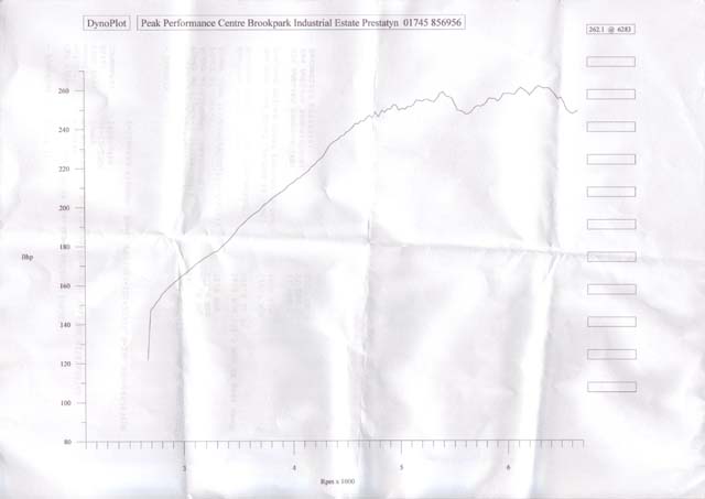

tuneable as well, I have only lightly tuned my coop and now have 260+ BHP.
Here's how much I spent:
Coupe - £3.5k
Custom exhaust - £100 (okay that was a bargain)
PRV - £22
k+N filter - £40
Drilled airbox - free
Boost gauge - £40
De-cat - £60
G-Tec chip - £25
So... an extra 40BHP for... £287 bargain!!!

pinin__prestatyn said:
Wow your coop's savage when it actually moves Hmallet :cool:
That was before the chip, decat and exhaust. It felt a whole lot more torquey and free-revving with them.
