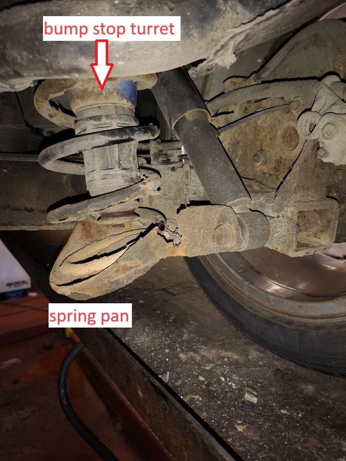

More important would be to check the rear sills and rear axle for rust. Here's where they go:
If it looks rusty, not necessarily a problem, quite easy to treat and rust-proof.
Check there's no deep pitting or cracks.
