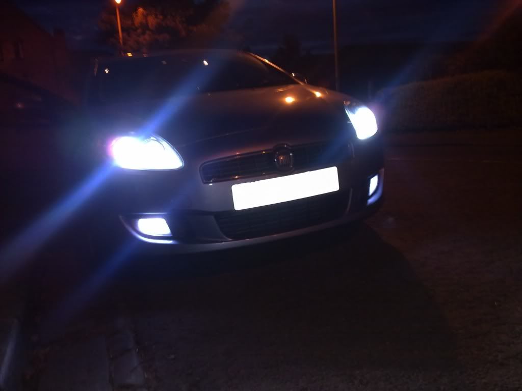

yeah all after market basically just changin bulbs over
if i remember corectly its
H7 for the dipped bulbs so it would be this kit but with 6000k bulbs i was using for a slightly blue effect on them
http://cgi.ebay.co.uk/12V-35W-Slim-...arts_Vehicles_CarParts_SM&hash=item3a639974f7
the sidelights are where the canbus system gets annoying ive tried 3 different LED but the canbus system overode all the bulbs i tried so i just delt with the orange warning light :)
but its a 501 sidelight
similar to these
http://cgi.ebay.co.uk/2-T10-501-Whi...arts_Vehicles_CarParts_SM&hash=item519932669f
and H11 for foglights i used these ones
http://cgi.ebay.co.uk/2PCS-H11-BULB...arts_Vehicles_CarParts_SM&hash=item1e63eac5f9

Man them lights are bright Daz.
