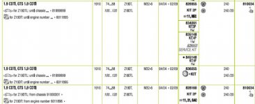

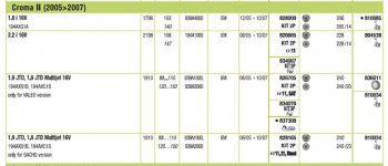

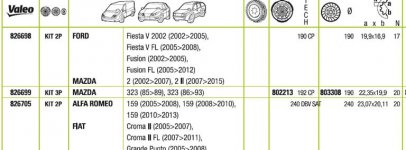

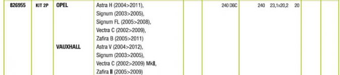

Hi,
Well it's the same engine and gearbox (assuming M32) as some Vauxhalls, but there appear to be options. One is number of splines, 20 or 23. I looked at the Valeo catalog here https://www.valeoservice.co.uk/en-uk/catalogs (for Croma, force of habit)
see images below. There are a few common units but you need to identify exactly what (Valeo for this catalog) clutch fits your car and cross compare the Vehicle list and kit list / technical. Examples below.
Robert G8RPI.
After much searching and cross checking many motor factors they all seem to state that the clutch uses 20 splines I hope it's correct
