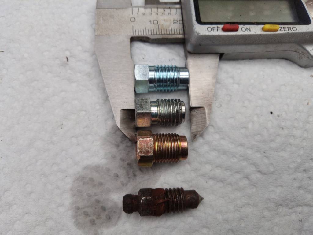

Good idea about making a brake nut Al.....but I patiently waited the three days it took a first class package to arrive. Fifty nuts for eleven quid
What simplicity when you have the correct part. Top to bottom...M10 x 1.25 long. M10 x 1.25 short.M10 x 1.00.
Plus one if the bleed screws I replaced, helpfully labelled "M8 Fiat" at my local parts store..appear to be x 1.25. [emoji106] IMG_20200913_121956_920.jpeg
