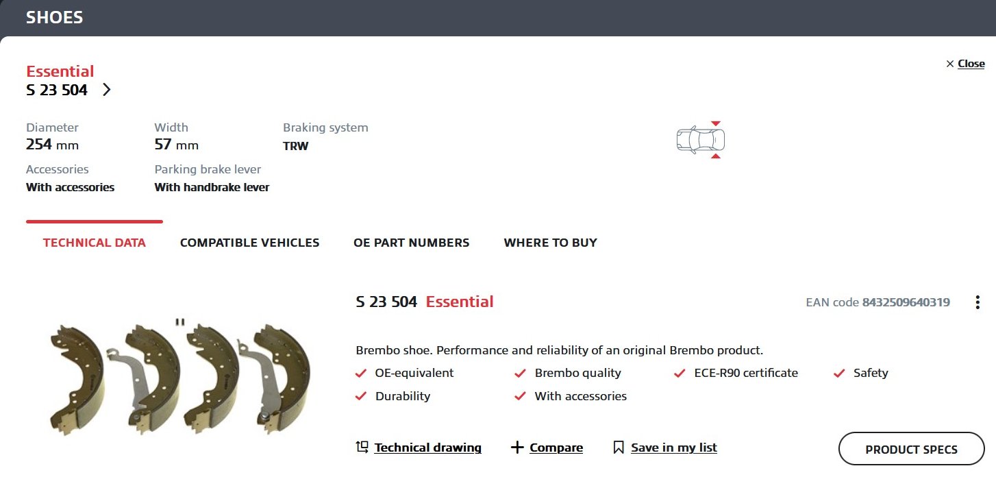

Hi Jules
Some more information. The Ducato 1 type 280 was 1981 to 1990, with the 2.5 litre engine introduced 1989. The Ducato 1 type 290 was 1990 to 1994. So your vehicle appears to be at the changeover, i.e. one of the last of the 280's but with the later engine normally associated with the 290. When searching for brake parts I have put in 280 and 1981 to 1990, but for engine parts you might have to put in 1990 to 1994.
In the UK I use online parts supplier autodoc.co.uk, but they cover most of Europe with different internet "shopfronts". See the attached picture for the search term I used. Once you find a part, there are multiple offerings from rival suppliers at different prices - I stick to the well known names.

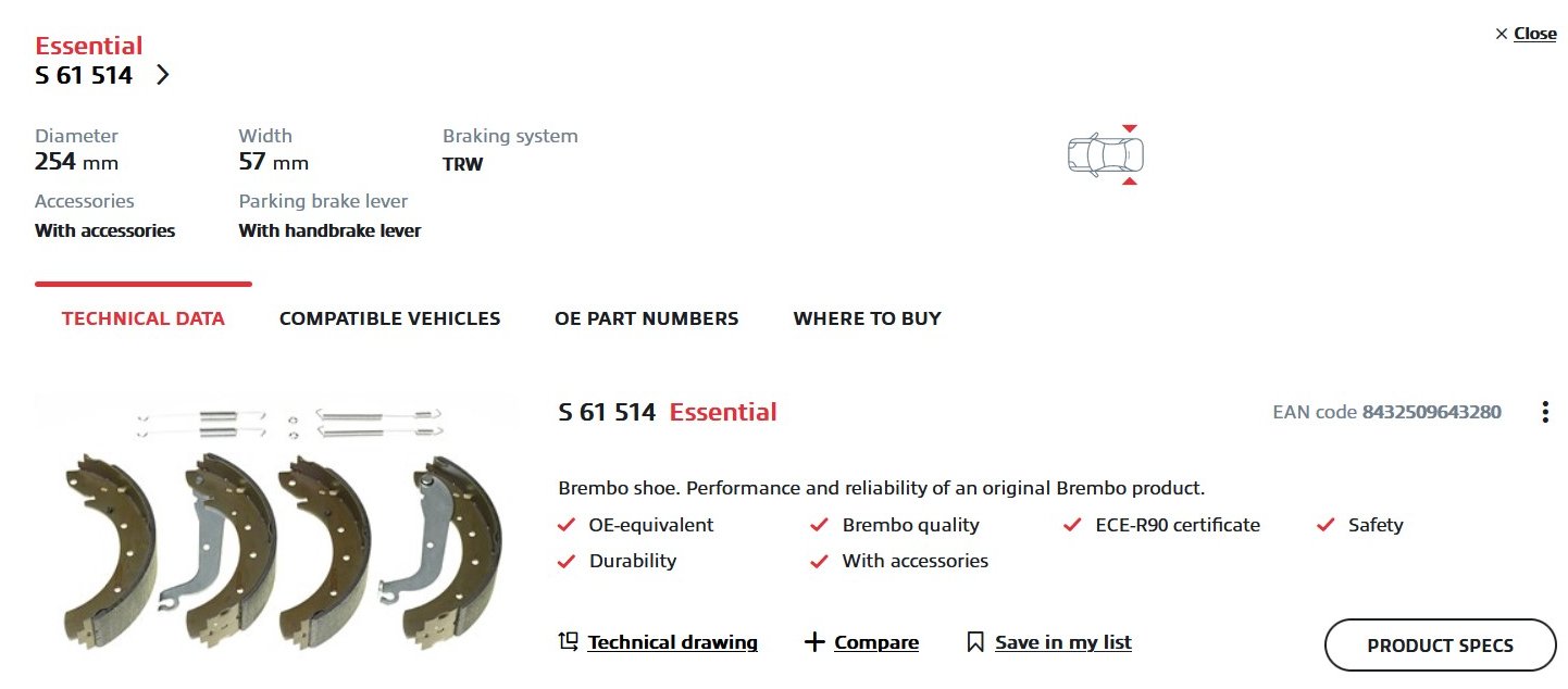

Your rear brakes are drums, so need shoes rather than pads. The size is 240 mm diameter x 57 mm width. The handbrake also uses these shoes, and the cable attaches by a lever. Unfortunately, there are two different lever styles, so you may have to take off the drum and have a look. See the pictures for the two different Brembo parts.

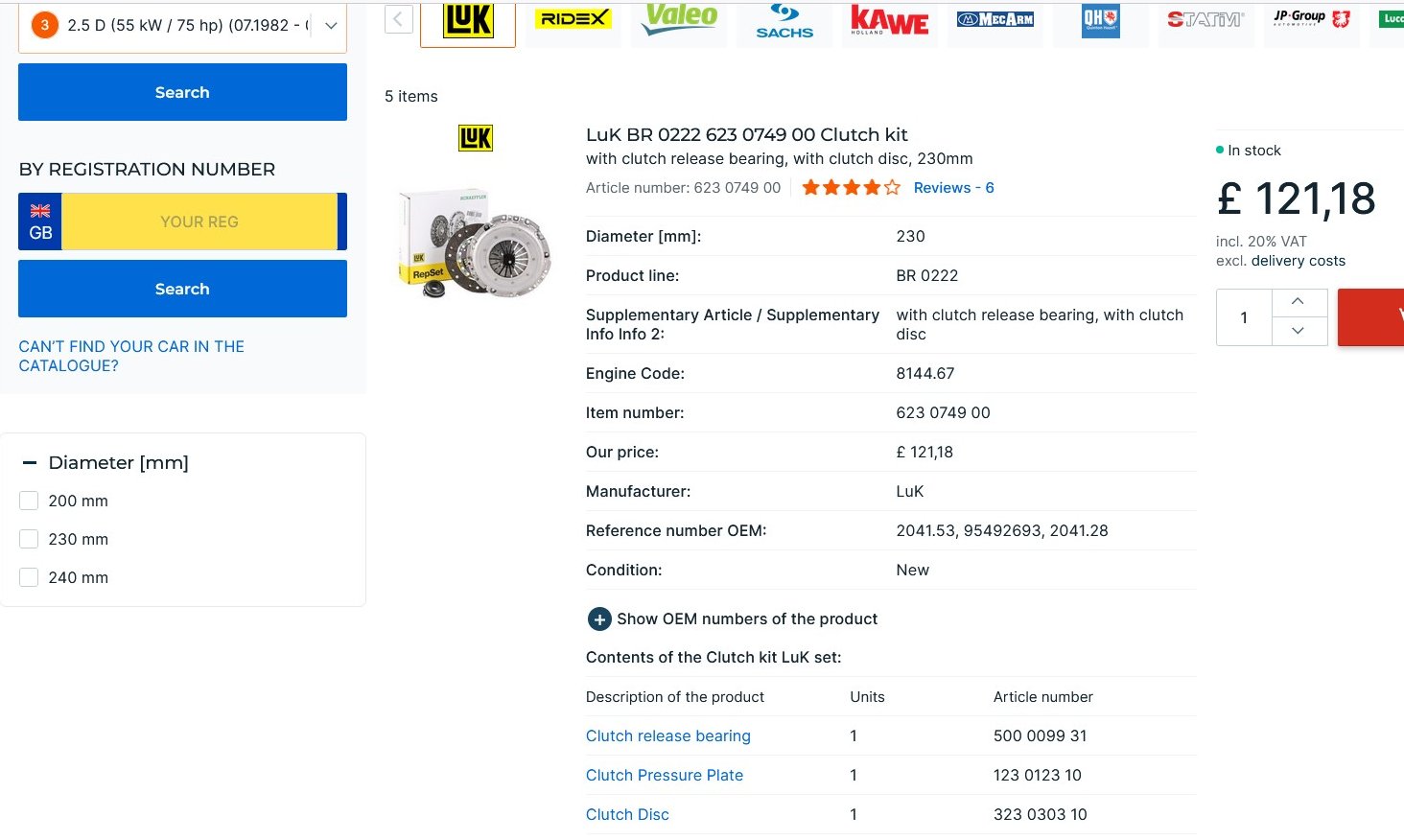

The clutch is indicated as 230 mm diameter for the 8144.67 engine. I show an example made by LuK
This is the best information I can give, but it is always difficult to be 100% certain because Fiat etc changed things throughout production and suppliers parts guides are never completely accurate. For example some sources indicate that the clutch is 240 mm diameter ! The only sure way is to take the Vehicle Identification Number (VIN) to a Fiat main dealer and check the Fiat part numbers so that they can be cross-referenced with aftermarket parts.
