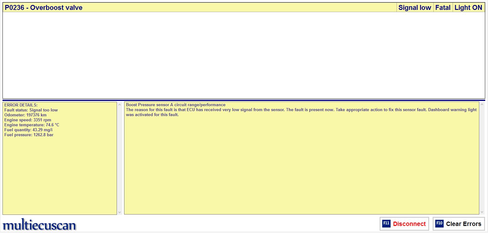

however, the car drives crap, very poor acceleration, and at over 3000rpm, i get engine warning light and limp mode.

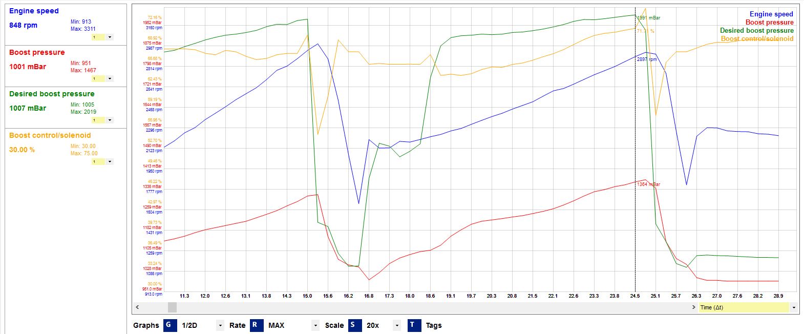

this is diagnosed as the Overboost Sensor receiving very low signal, which figures because i then plotted a graph to measure desired boost against actual boost, and i'm always down by around 40-50% according to multiecuscan readings as pictured.
something clearly isn't right!

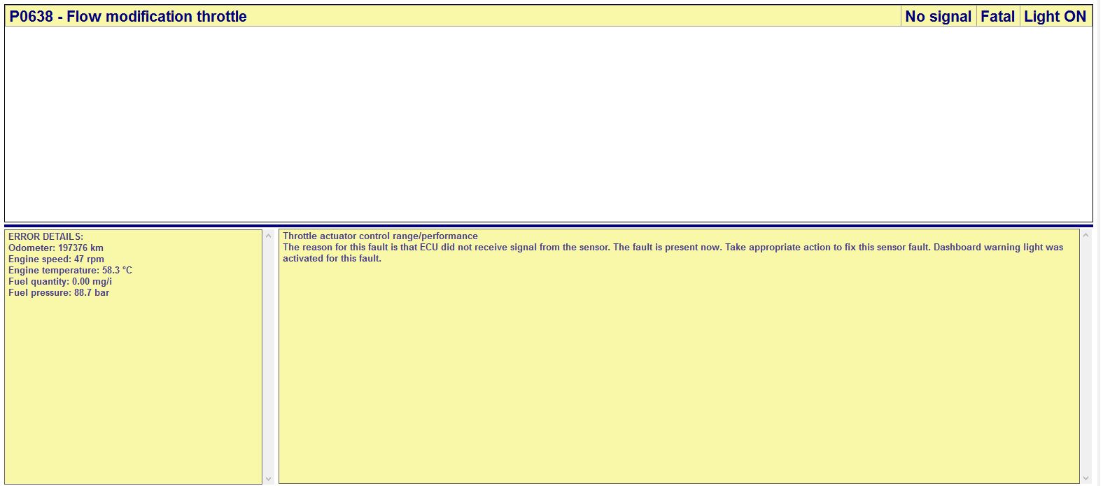

see here, item number 2, is Flow Modification Valve, and is linked to the throttle potentiometer circuit. Disconnecting it brings up this fault P0638
it is attached to the Vacuum Tank, and i believe looking at the eper picture, it should be linked by hose to Flow Modification Valve by the short rubber elbow
pipe.
i'm not sure yet how the vac lines interact via this valve with the boost levels, but i'll keep going.

Ok, we are back to running again, and with full Choo Choo boost that follows the desired boost very well plotted on multiecuscan.
