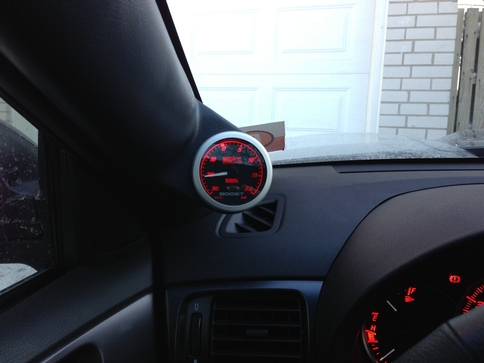

I thought about getting one.. if i did i would have bought a spare A-pillar panel and would have modded that with some fiberglass, bondo, spray paint.. to install the boost gauge there. ..
any OBD => Bluetooth app will have vary big delay/response rate => you will not be able to spot any boost spikes!!
+ it will only see what the MAP sensor sees, that means that as the sensor ages you will see less and less boost.
A mechanical boost gauge would be the best.
Yeah it's pointless not having a live reading. I will get a mechanical one just want a decent place to mount it to look oem as possible.
That's why i suggested a pillar mounted one..
If done properly it can loo pretty OEM:
You do need to DIY a bit. and get familiar with fiber glass.
But if you buy the A-pillar panel from the scrappers then you can always go back to original if you don't like it.
Mine is tucked in the corner right under the A pillar. I got a cheap metal mount from eBay and bent it to fit in the space. Its stuck down using some double sided numberplate tape.
I'll post a pic when I get a chance.
