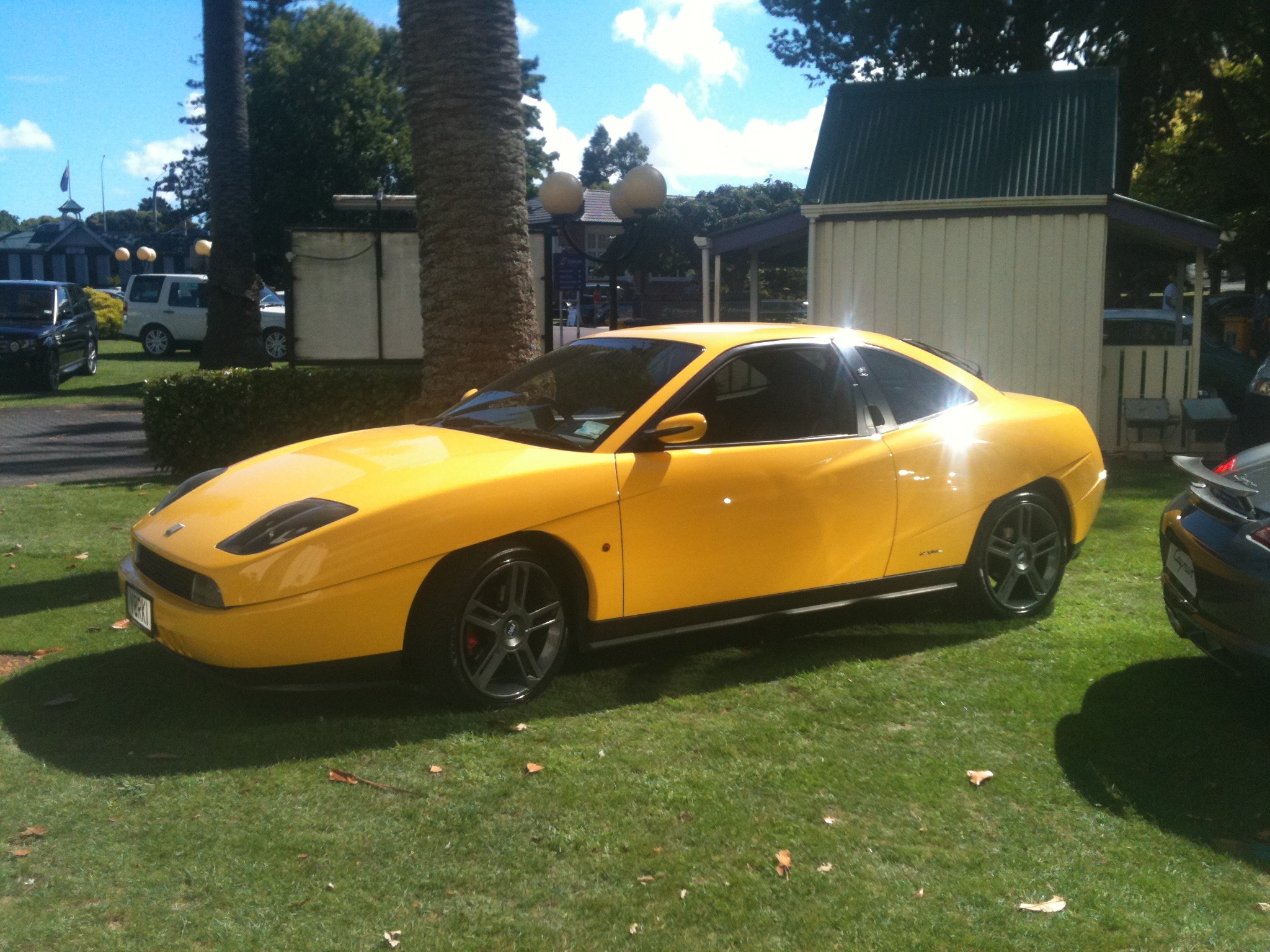

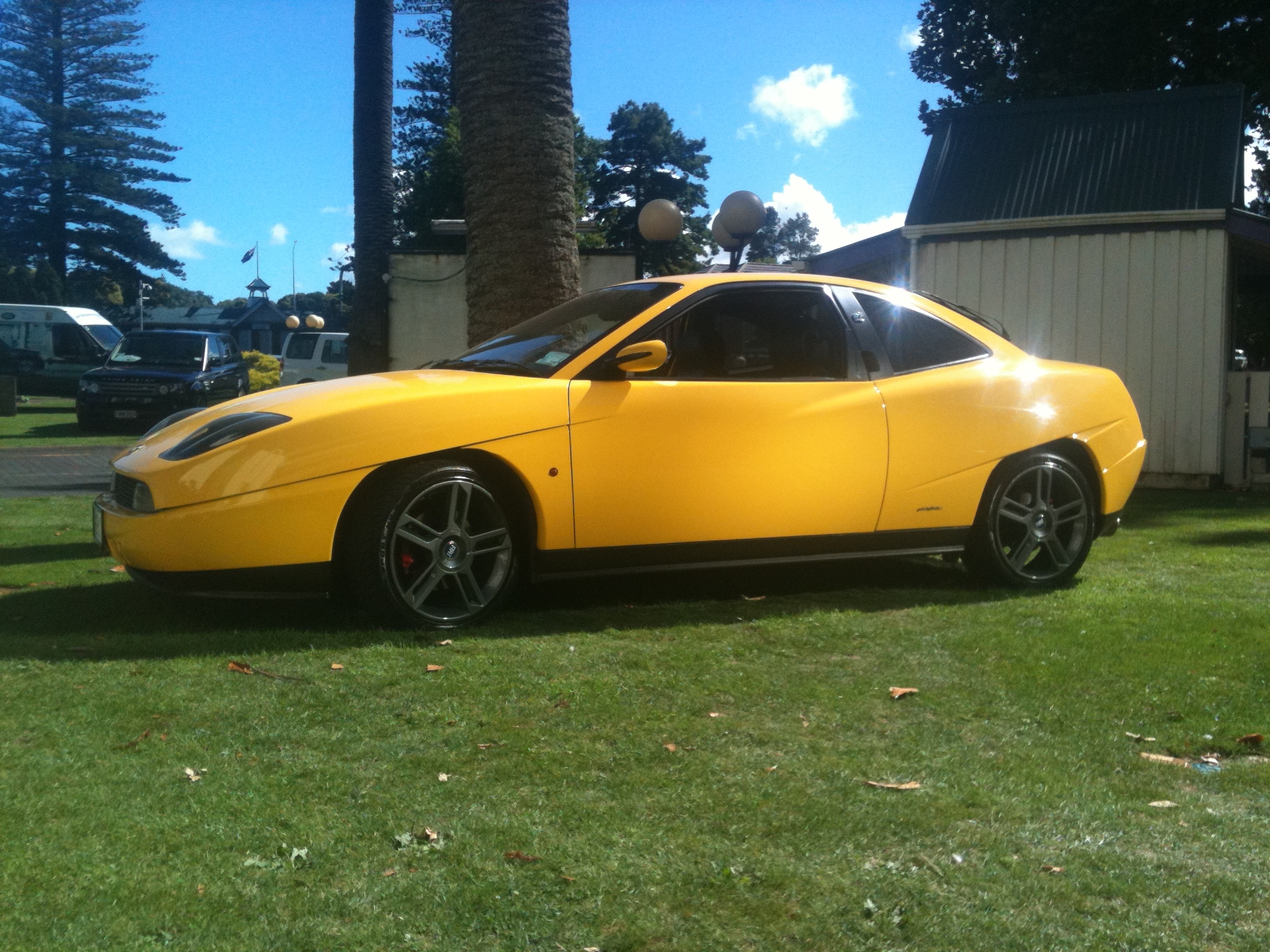

Would love a pair of those, where would i get them from and how much cash am i looking? also does anyone know a good site for wheels for the coupe so i can look at a few? many thanks, Paul.
As pinin says they require spacers to clear Brembo's on the 20VT they will bolt straight on to the other fiat coupes though. Had these on my N/A and it looked bang tidy.
I think 20mm on rear may be just too wide and cause rubbing issues on the rear arch lip,
my 20mm hub centrics did with my stock 16" 20Vt alloys.
I have a feeling Patch from fccuk is running 15mm hubcentrics all round with additional 3mm spacers just on the front giving 18mm to clear the Brembo's
