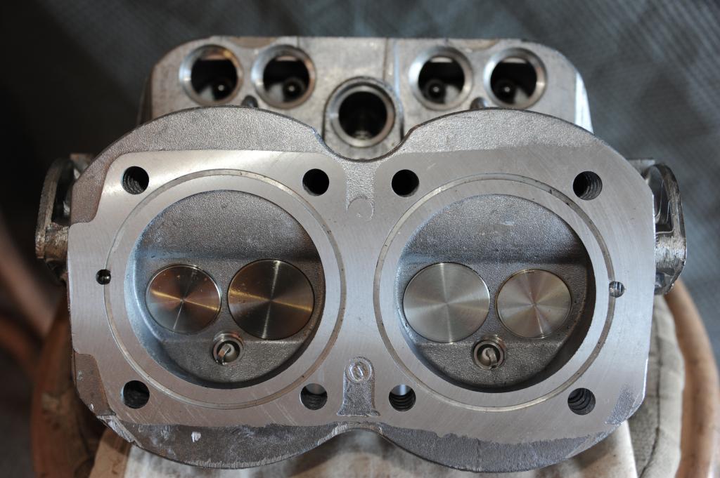

I picked up my 'big valve' head last week and would have posted earlier except for some major computer glitches.
I've attached a photo I took when I picked it up and before my computer died. It has been cleaned, checked and fitted with 35mm intake and 29mm exhaust valves on hardened seats. I guess I could have fitted larger valves, but these are a good compromise between better breathing and the structural integrity of the head. I've seen photos of heads where the valves virtually touch. The inlet valve area is up 20% and exhaust valve area by 7%. The inlet port has also been enlarged and polished to take the bigger carburettor.
The head has had a little bit shaved off and once it's mounted with a thin copper head gasket should give a compression ratio of about 9:1 - more than enough for what I want.
