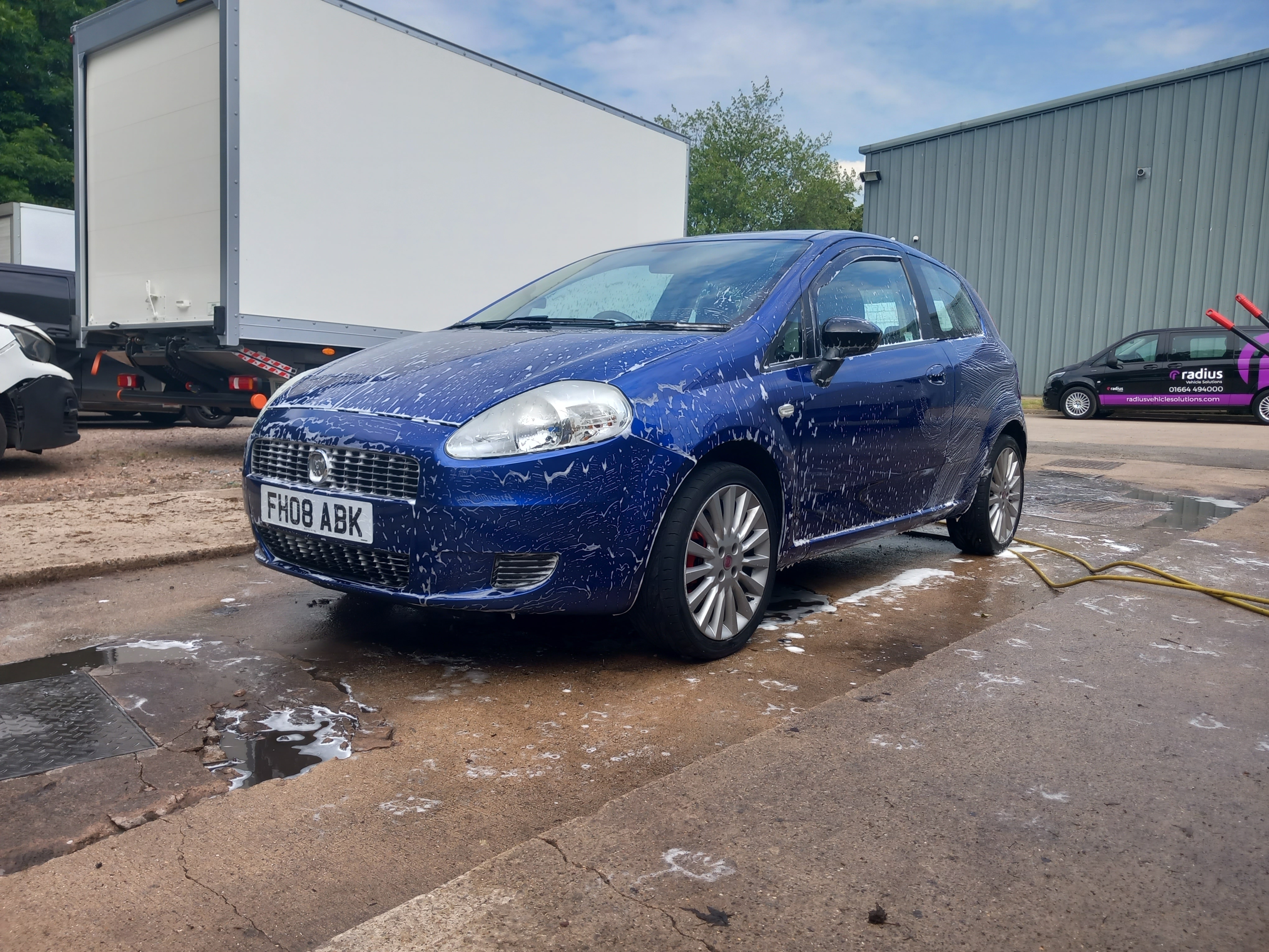

Hi,
I've had this little Italian nugget for over 6 years now. It's currently on 195'000 miles, not bad for a 1.2.
However, the lack of power has been a consistent issue since I got it.
To rectify this, I'm installing an Abarth 155 engine at somepoint in the next 12 months, with help from an experienced specialist/breaker.
I have most of the parts as below:
199a8000 engine with all ancillaries and flywheel
Intake and exhaust
C510 box
ECU, BCM and Main engine wiring loom, ignition barrel and keys
Driveshafts
Radpack and intercooler
Clutch kit
Cambelt and service parts
Bit of a frankenstein build, but I'm stuck on a few odd parts though. Main one that is bugging me is the wiring loom from the ECU to the BCM, which needs to not only be from a grande punto tjet but specifically one with the old BCM (square shaped black key). Does anyone know the part number for the loom? I'm grasping at straws trying to find this wiring loom without the part number!
Thanks :)
Damian
