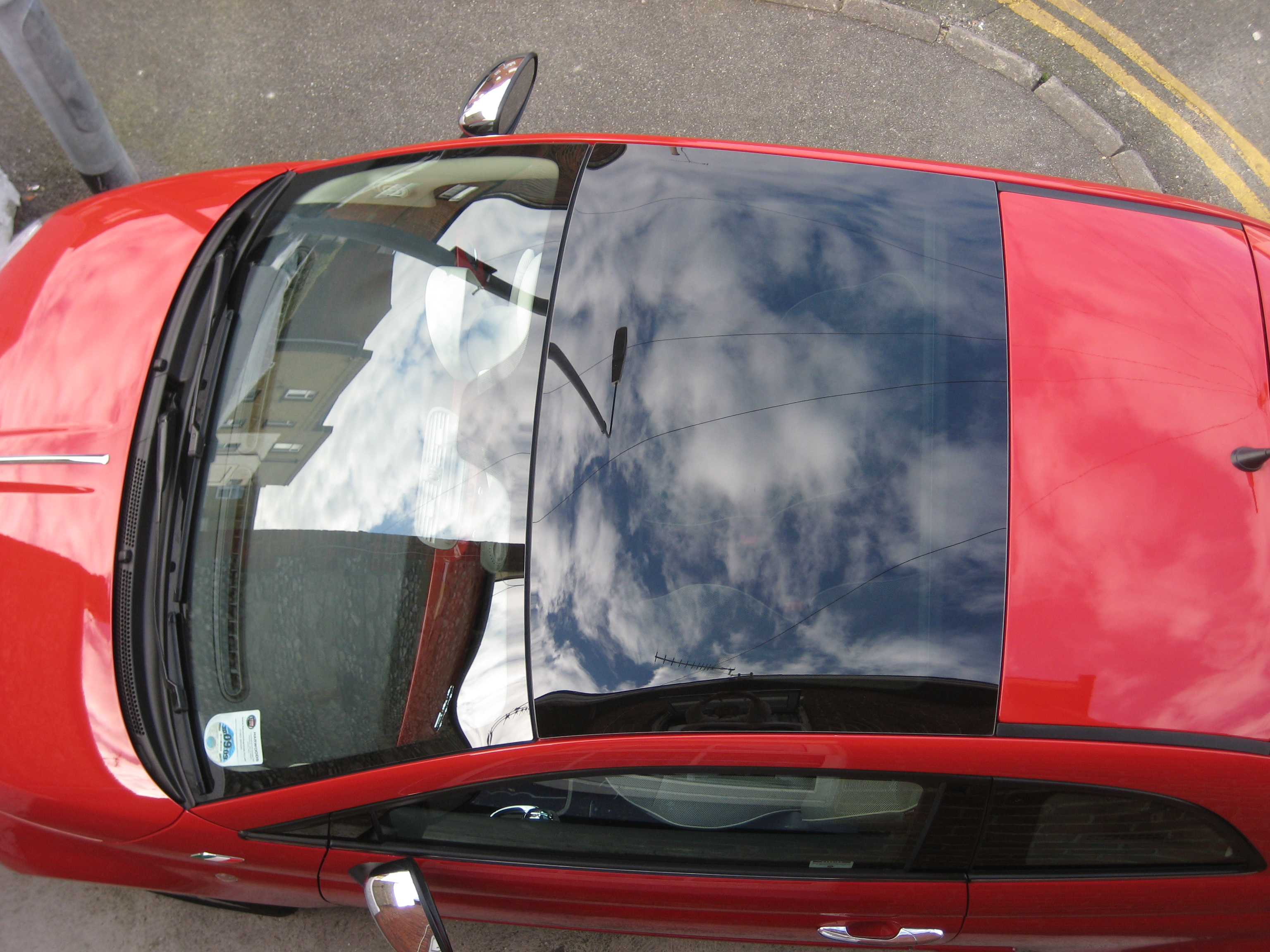

I finally ordered the recommended products, Spent a fair amount of time using them, i'm really pleased, thanks for the advice
Check my reflections!
