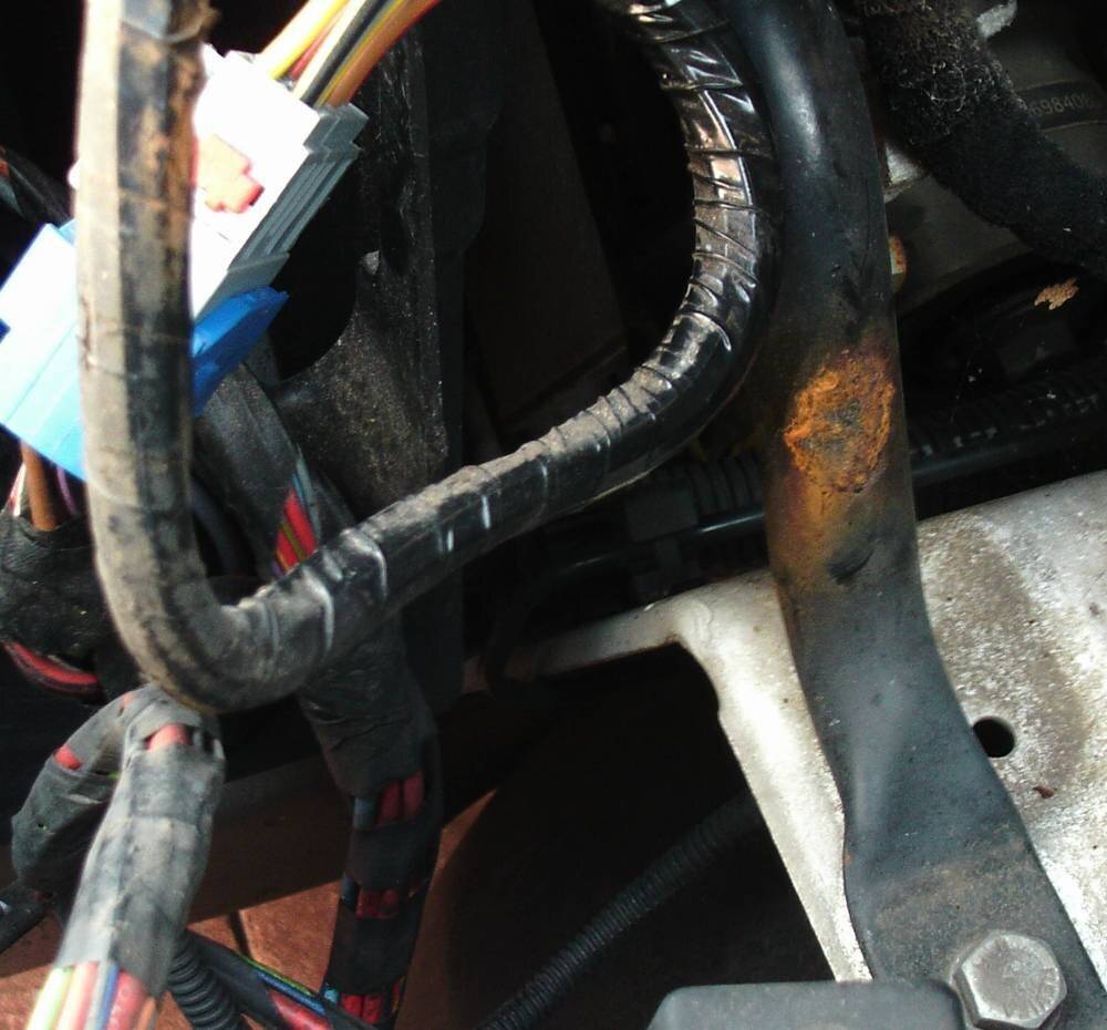

The Ducato suffers with a myriad of issues, such as but not limited to water ingress reaching the ecu and fuse box, a fragile branch of the wiring loom which rubs on metal work under the bonnet causing high resistance or open circuit breaks in wiring, bad earthing straps but also issues with egr components and I’m guessing from your post you don’t wish to self diagnose/repair.
