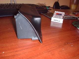

I`ve got the previous model in mine,
and yep it will hit the bottom of the fascia heres why;
Pete
Sig courtesy OF Roberto! (Cheers Man)
you will have to adapt a facsia to bring the head unit forward
this does give one advantage, shed loads of room for wires behind the HU, i`ve got phonos for the sub, phonos and control lead for a changer with loads of space no probs

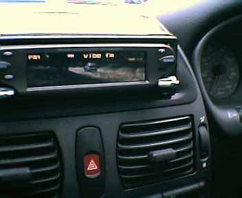

Profile view of mine;

basically i sat a radio cage (the metal frame thing) in an adapter fascia(glueud in), forward enough so the face`s drop (19mm) would clear when opened,
then built it up with filler and faired it all in to look half decent!

I used nearly a litre of P38 (you know the body filler suff) on the radio fascia
i abused P38

@ light warriour - yeah blended it with filler, but the cage is glued in with sikaflex (spelling correct!)
Paint with normal spray paint
