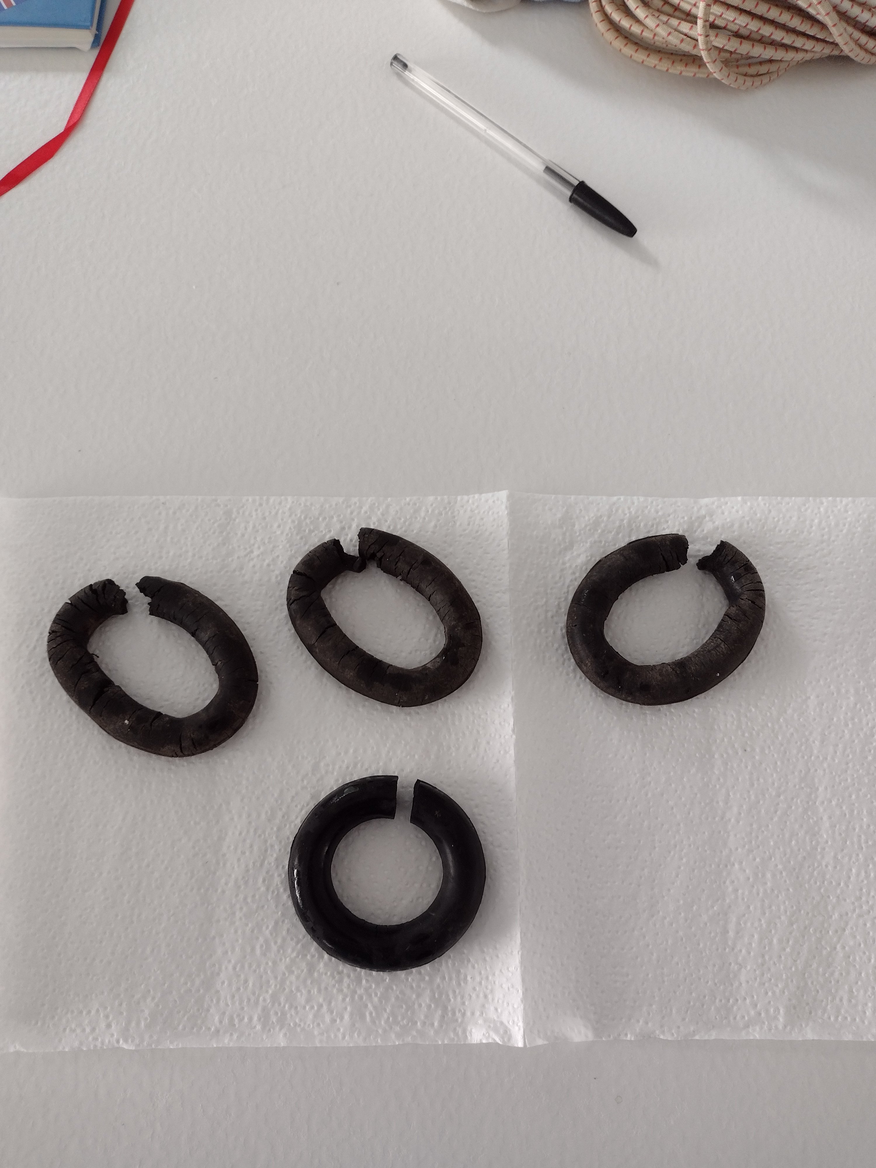

Further to my thread " Issue with garage".
My rear brakes failed the MOT 3 months after the same garage had repaired them.

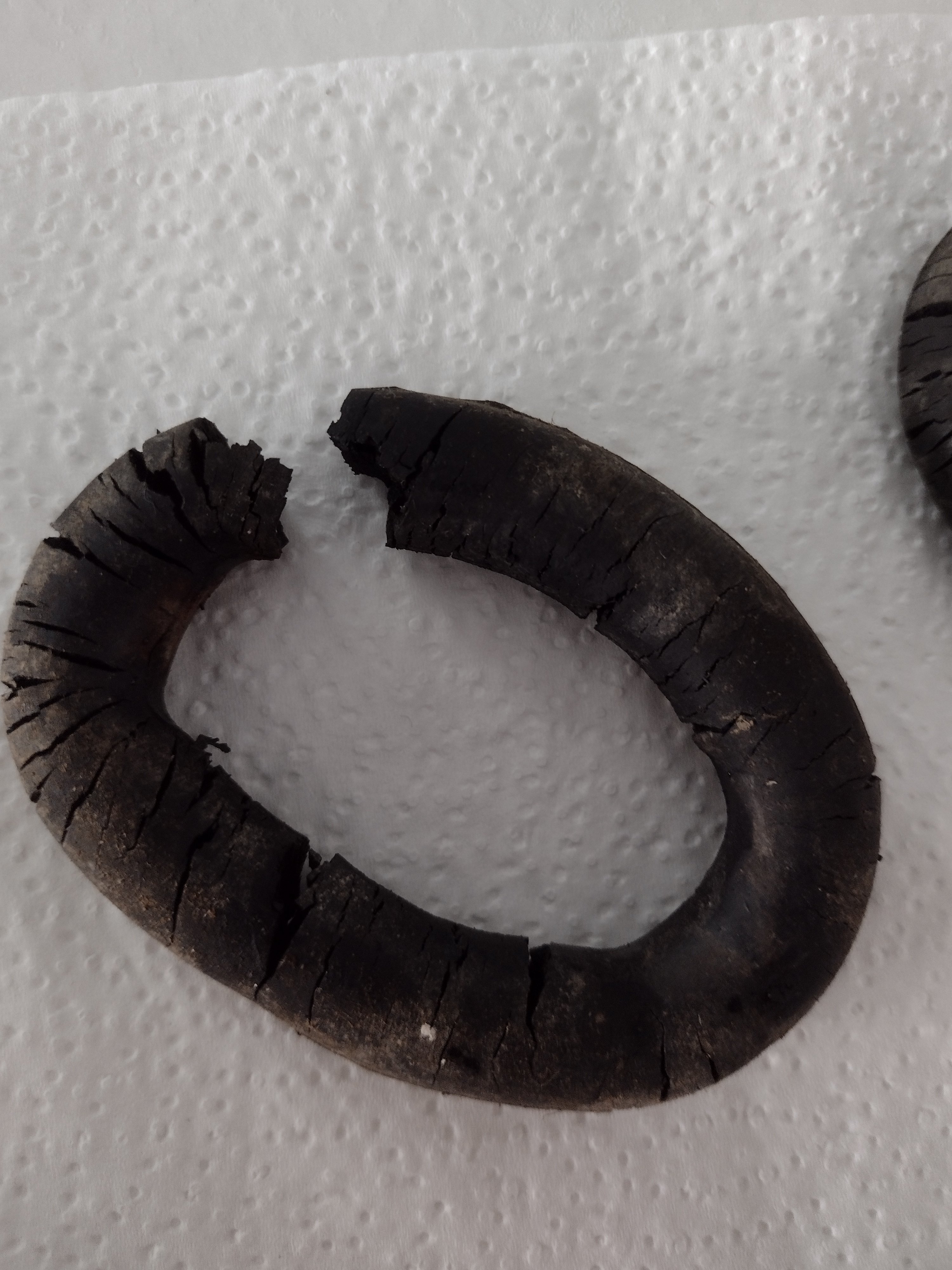

I was about to use the motorhome today to find the exhaust was on the floor. 4 exhaust mount rubbers badly perished had broken away. 1 just holding up the muffler and the other muffler mount missing(I assume it fell off on the road sometime)
The MOT advisory stated a slight leak on the exhaust nothing else. In actual fact on closer inspection the front pipe to the centre silencer join has completely corroded and can see daylight through it, just a bit of metal holding it together. It's 7 weeks since the vehicle passed the MOT.
It doesn't bare thinking about if this had happened on the road, just so lucky it's happened on my drive.
I will be making a formal complaint to the garage and the DVSA again.

yes, you need to keep an eye on those rubber donut exhaust mounts, there are three on my ducato 1.9TD and check them every year and change them if i see any sign of perishing, I have a box of them in my shed and it only takes 1 minute to lever off old donut and replace

Agree. I'm going to fit a metal strap so if it happens again it will fall onto that and not on the road. I dare say that will be wrong at the next MOT. Rotten support rubbers no problem🙄
