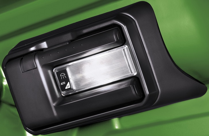

Found this little gem for £11 genuine Citroen part in its box............Course i bought it

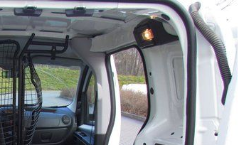

Fitted the light today ..............well that was easy(y)
Original light just Un-clips then unplug connector.
The new light is in two parts, the back part screws to the bodywork with two large self tapping screws into the holes already in bodywork, then plug in new light to connector plug and simply snap in the light to the back part.
The light has three modes, off,on,and auto.
I'm not sure about the charging bit, but it charged from flat in about an hour.
The torch has 4 AAA rechargeable batteries inside and these are replaceable.
This Gizmo going to be a blessing as trips to the loft are often the case in my line of work
I've patted my self on the back and treated myself to a pint of ice cold cider:D

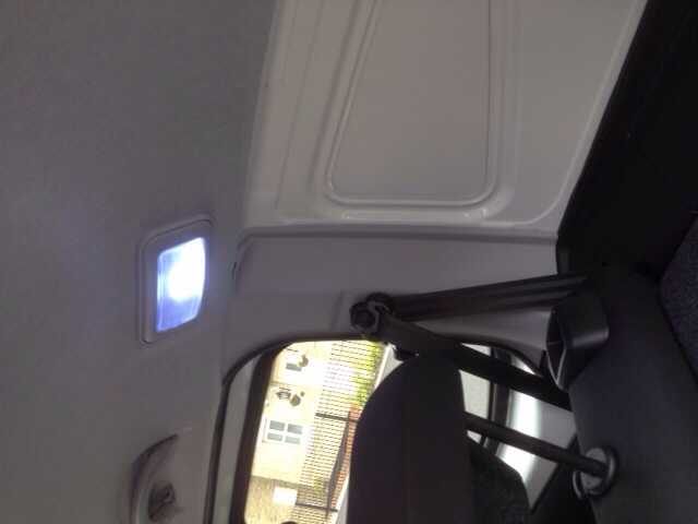

Yes my light is there in the roof, but have the full roof lining as the car:
The one you have when i've zoomed in on it does look like the one i used to have even though i have nothing but metal on show, i can't see why the other light won't fit.
Just to add, my new light does have i gap between it and the body indicating that there is headlining missing.
