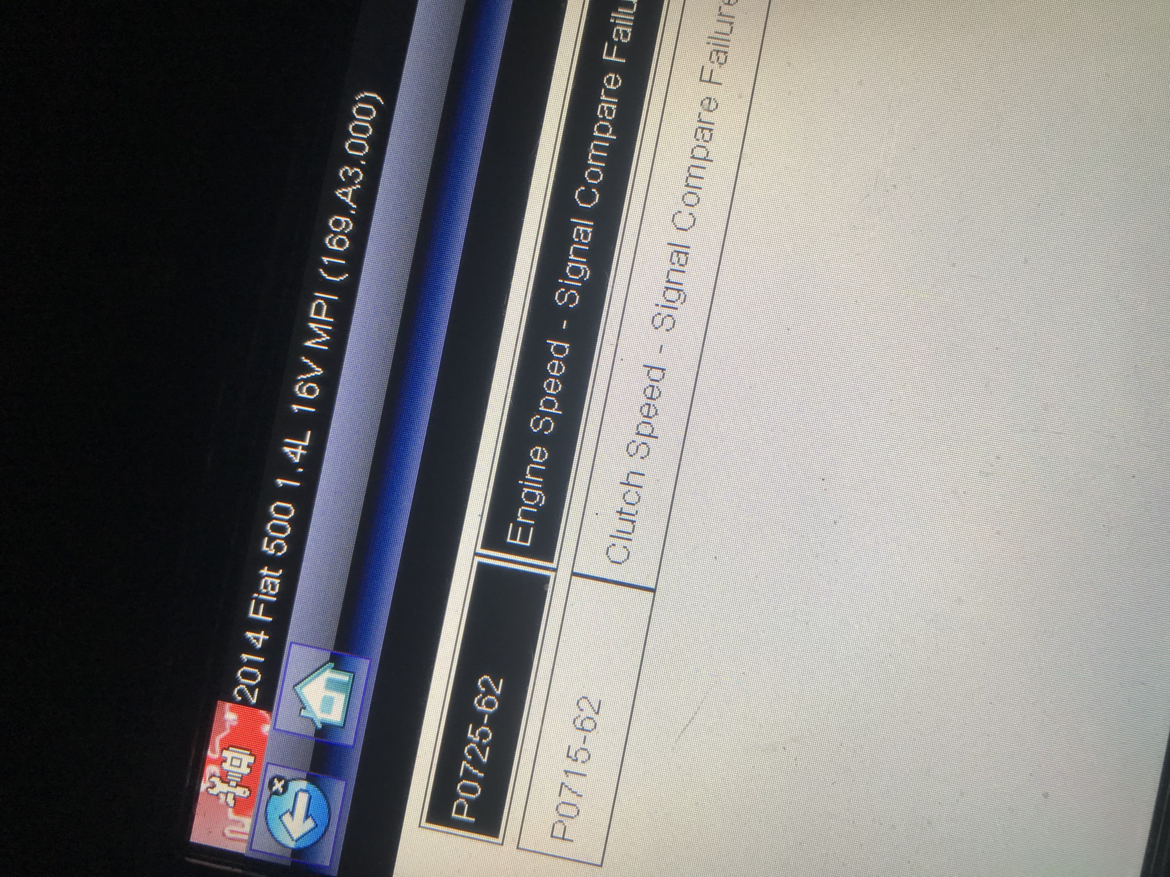

My partner has a 1.4 2014 semi auto 500.
We have recently just got a issue with the transmission.
It’s jumping out of gear randomly at times, goes into limp mode only allowing 1,2&3 gears.
I plugged the snap on computer into it tonight ..
Any ideas on what the actual issue is and how to fix ?
Take a read of the post below "one and only durologic failure " there seems to be several issues often its the actuator that a an issue especially if there's fluid leaking but also recently several people have had new clutches fitted and it's transformed the car I would suggest taking it to a garage that's had a lot of experience wolith this type of gearbox.
