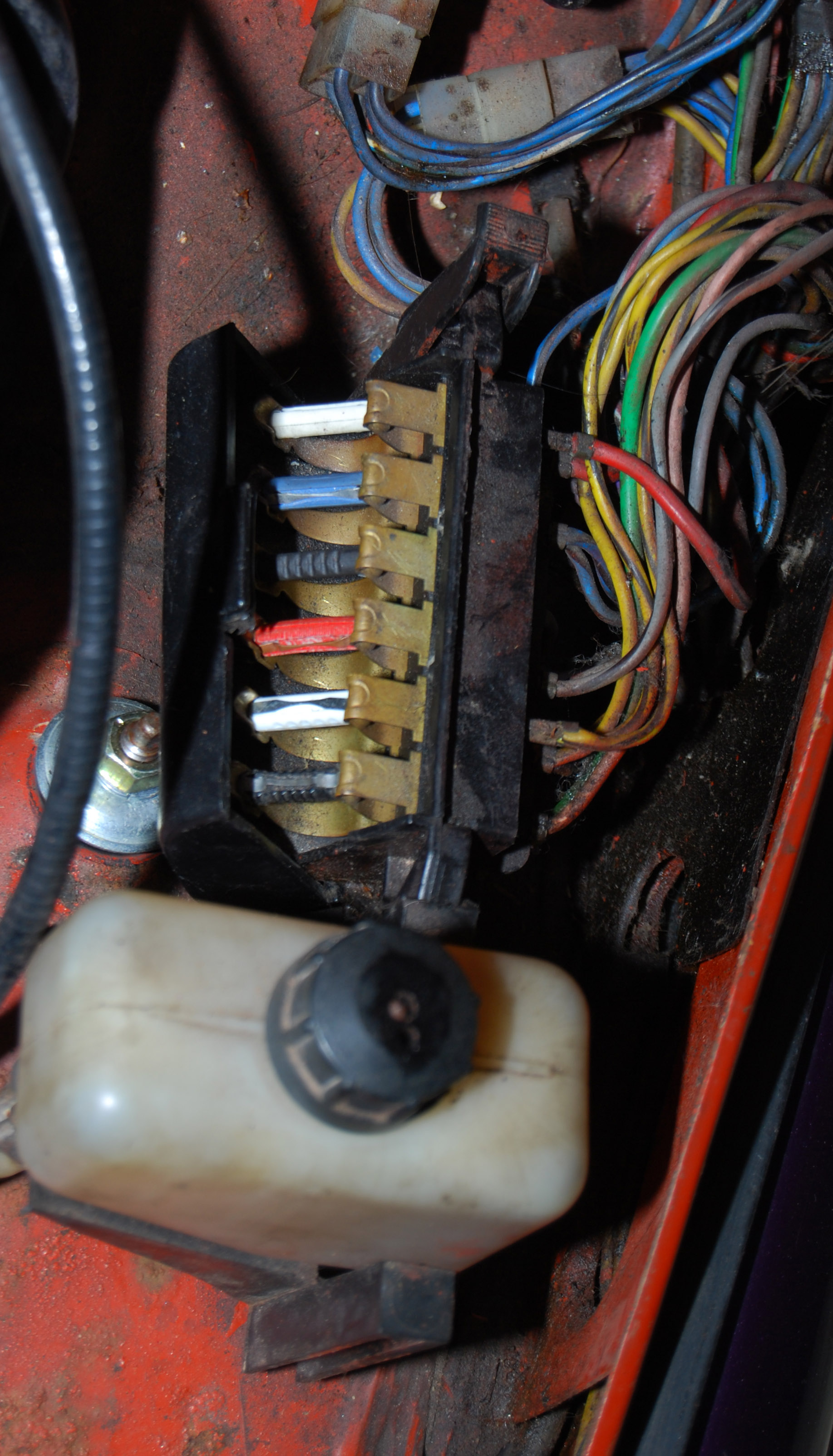

Could someone tell me the amp needed for the 4th and 6th fuses for a fiat 500 F?
or better yet, all of the amps in their respected slots to double check the previous owners work?

Hope this is of some help............(y)
thanks for the pic, but apparently those fuses are hard to find and i could only find ones that fit a VW bug, but they might work, but the colors are different. what i need however is the number of amps engraved on each of the fiat fuses.
thanks for your time.
clay
Hi Clay
I don't think the fuses in our car are colour coded, but given the following information:
3 - Fuse No. 56/b1 - Left headlamp low beam4 - Fuse No. 56/b2- Right headlamp low beam.5- Fuse No. 15/54- Winking direction indicators with pilot light
- Instrument cluster light
- Stop light.6- Fuse No. 30- Horn
- Windshield wiper
- Rear view mirror light.
it seems that fuses 3 and 4 would be the same type.
Fuse 6 carries quite a hefty load, so I reckon if you used the same type as in fuse 1 and 2 you should be fine.
Next time I drag our car out I will check and see if the fuses are marked.
