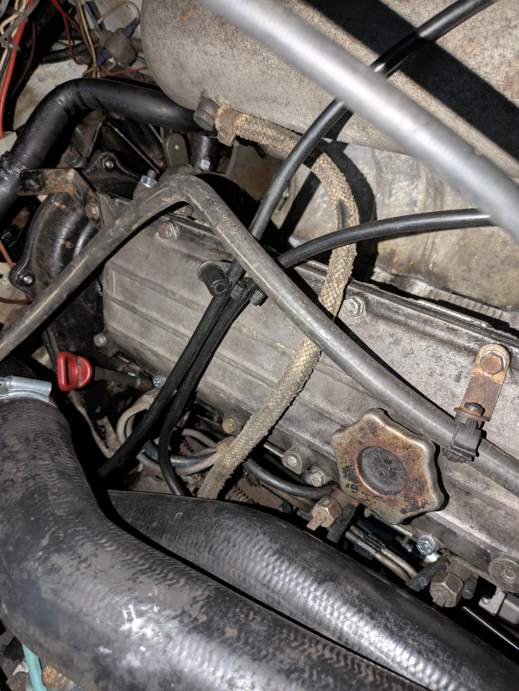

This is what my turbo looks like. It doesn't look like the arm is adjustable.
However
1) the arm does look fairly corroded
2) i did try to move the lever (on the RHS) the arm connects to but it does not budge when i use my hand.
Do you think i should be able to move the arm by hand?
Is it possible this mechanism is corroded to the extent that it isn't working?
What should i do (spray lots of WD40 on the area? force it by hand?)?
