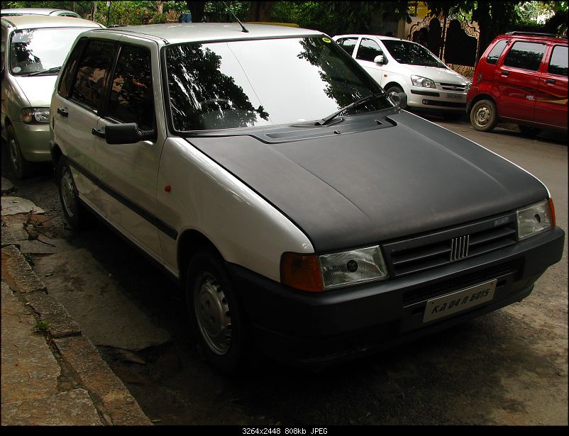

or apart from all this work, is there any other mod which you guys would recommend that i carry out on my car. i am attachin a pic of my car below.

looks nice!
