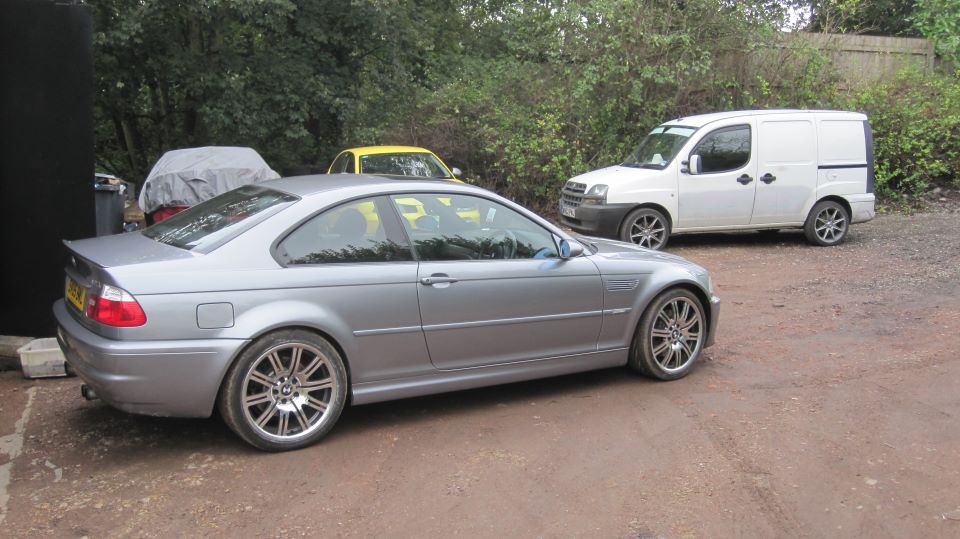

205 40 17 is sweet but runs ride a little rough but very good when cornering.!!
did not really notice much more drag from the extra wide wheels.
also 4x98 is PCD
don't rub on full lock no nothing, one thing to take into account though if you go for this size is too keep and eye on the tracking and lower wishbone bush's as these seem to take a battering. :slayer:
