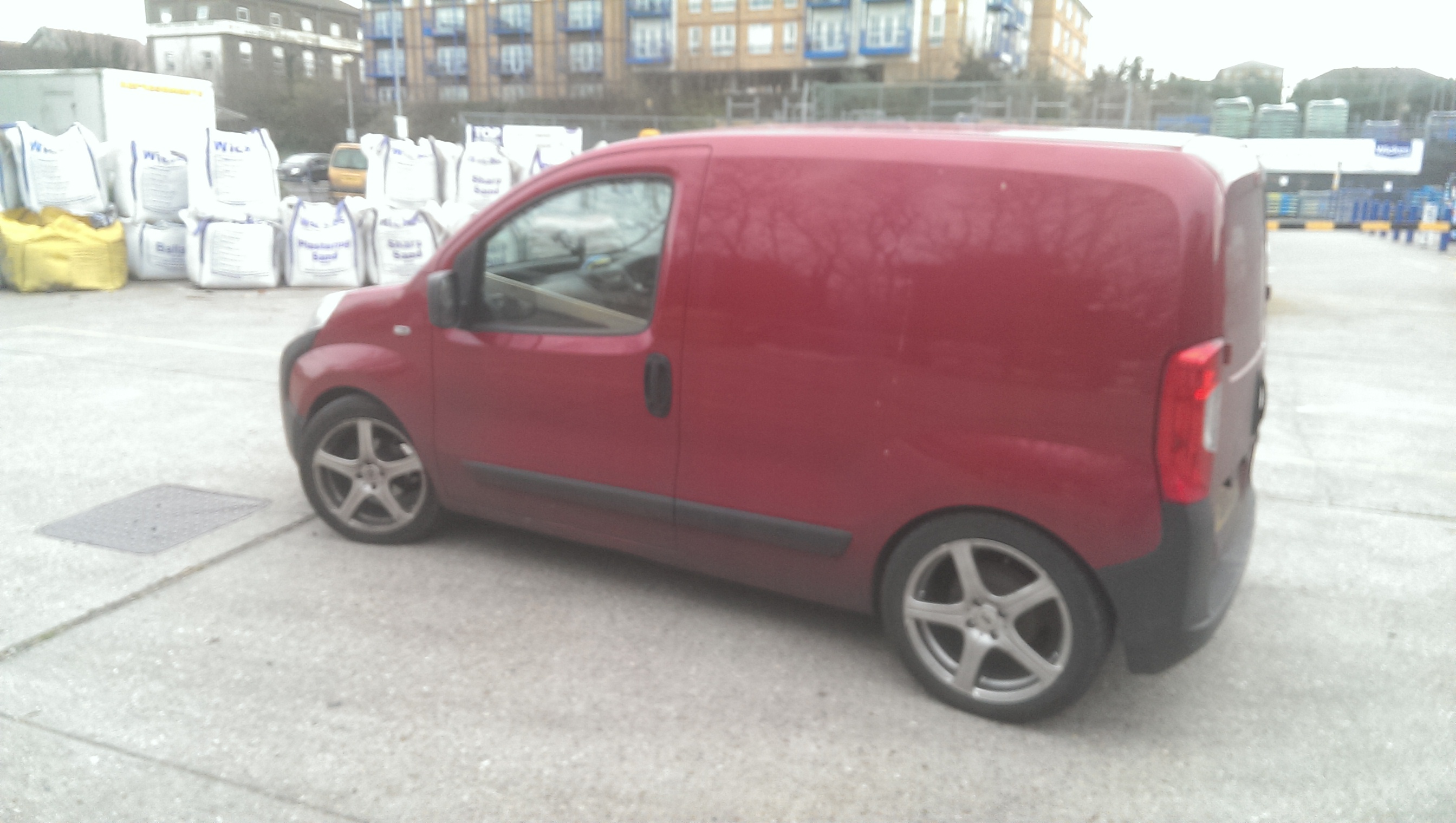

Your after 98pdc 44 offset
Fiat stilo 17'' blades are the perfect fit
Check out the one's on my van
There are some for sale in the classified section

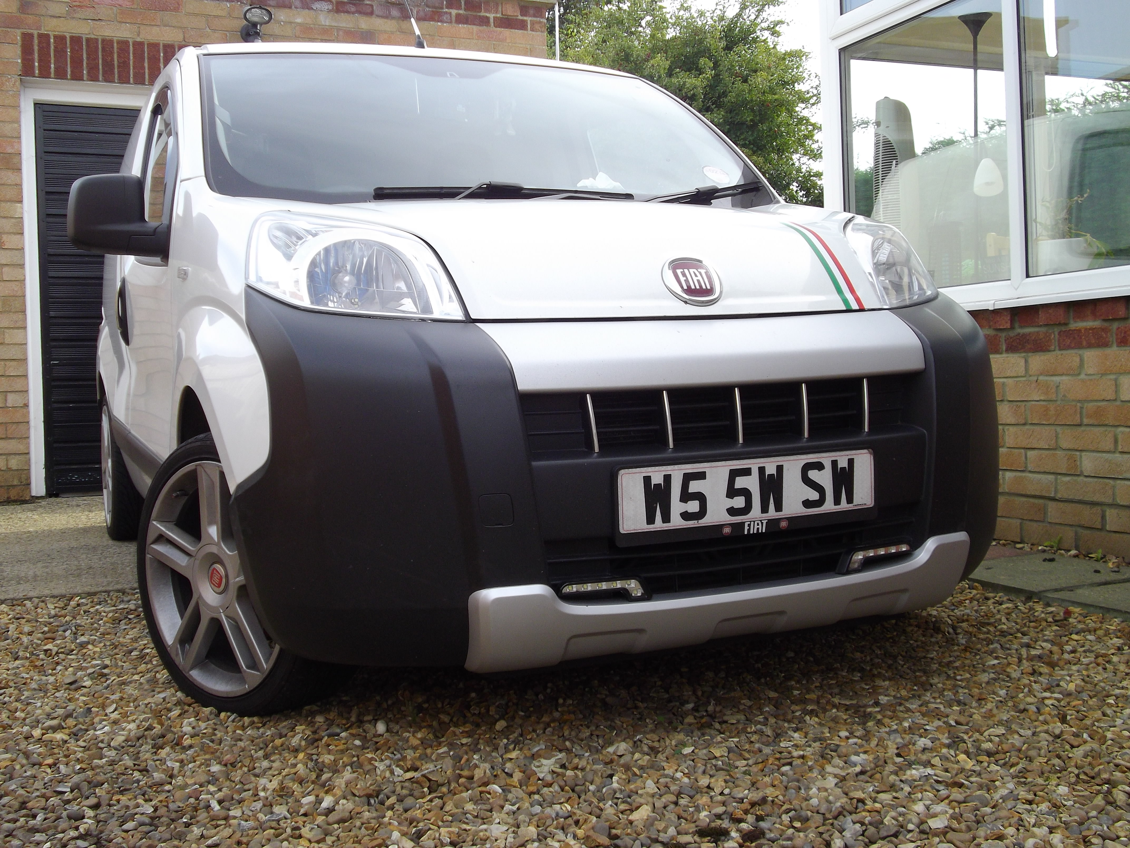

Got mine on eBay ages ago, even though my van is a Peugeot it uses the same pdc as the fiat, be careful with aftermarket alloys as you may have trouble getting they to fit with the wrong offset.
